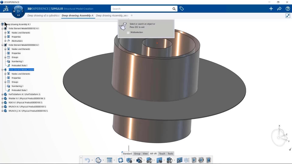

Scenario - Improved modeling capabilities for including manufacturing effects, pre-loaded sub-assemblies, from previous simulations in downstream applications (e.g. multi drop test) to accurately capture history dependent simulation use cases

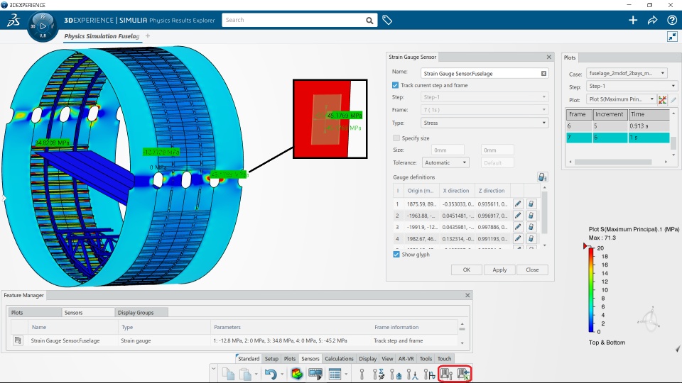

Post-Processing - Virtual Strain Gauge creation tool to define and output simulation results consistent with standard physical test measurement methods, and help determine best strain gauge locations for test

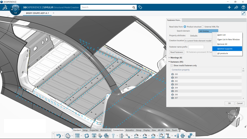

Modeling - More options (e.g. search domain) provided for the fastener creation automation using data coming from the CATIA Fastening app
