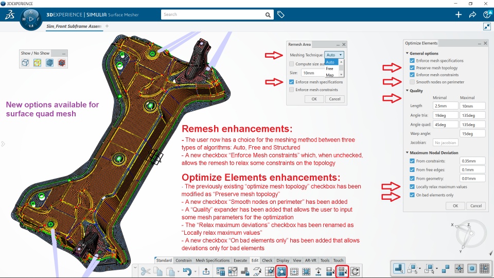

New options for the Remesh Area and Optimize Elements tools increasing the mesh quality and mesh task efficiency

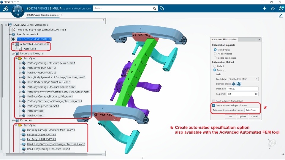

New option to store mesh and properties automated specifications as a recipe in a dedicated feature facilitating mesh regeneration after a design change

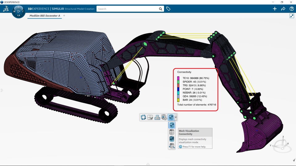

Visibility improvement by adding legends to colored mesh visualization (mesh quality, mesh orientation, interference, etc.) to better identify the elements associated with the visualization criteria

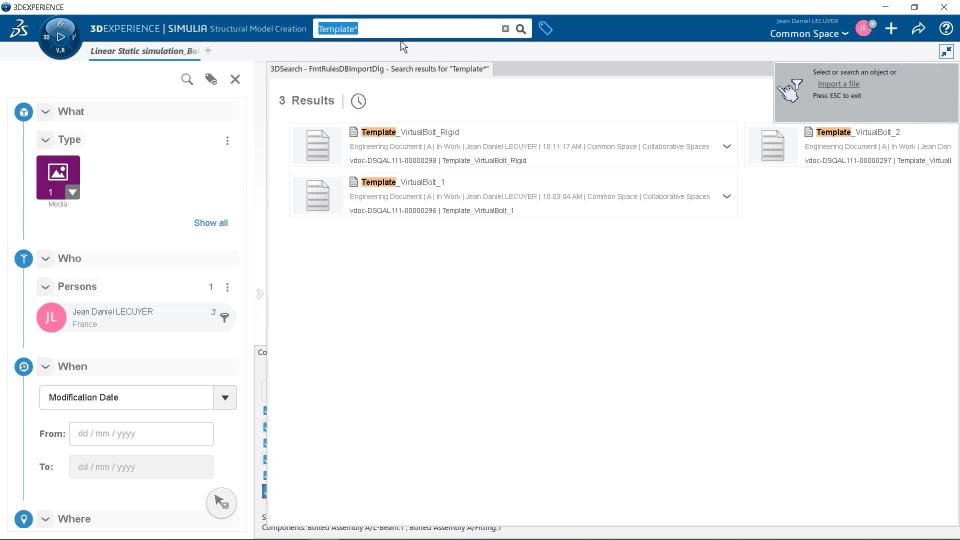

Various user experience improvements in dedicated dialog boxes for the templates (creation, management) making them more easy to use
