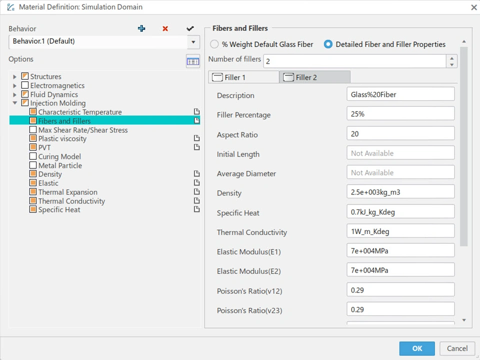

Benefit from solver support for the simulation of fiber-reinforced plastics containing a mixture of two or more fillers

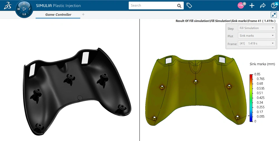

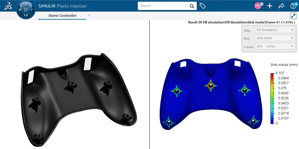

Sink Marks prediction in R2024x FD02 and earlier releases showed nominal values across the entire model, which is not ideal.
Benefit from a new solver developed in R2024x FD03 to predict with improved accuracy the location and depth of sink marks. The new improved Sink Marks prediction shows values only underneath ribs and bosses, which matches real-world behavior.
Benefit from enhancement to the 3DEXPERIENCE Plastics Materials Database, which now supports detailed properties of fillers thereby increasing the simulation accuracy of fiber-reinforced polymers.
