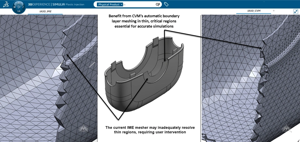

Benefit from faster and more robust simulation of single- and multi-component plastic products through improved mesh creation

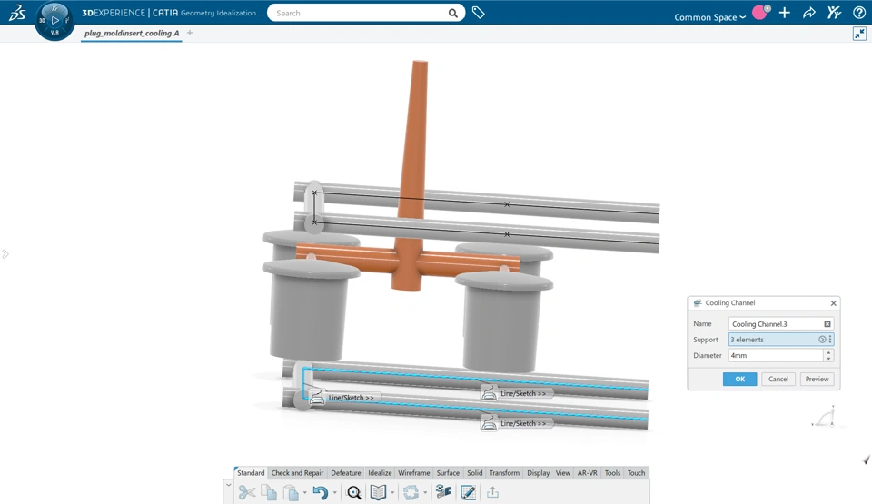

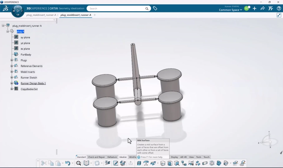

More efficiently model mold design features from sketches using dedicated Runner Design and Cooling Channel Design Commands in the Geometry Idealization Essentials App

Benefit from optional Convergence Volume Mesh (CVM) procedure to achieve more robust conformal mesh generation and improved quality and efficiency of boundary layer meshing.
Quickly model complete Sprue, Runner, and Gate systems from sketch entities using the dedicated Runner Design command in the Geometry Idealization Essentials App.
Leverage new Cooling Channel Design command in the Geometry Idealization Essentials App to create cooling circuits from sketches.

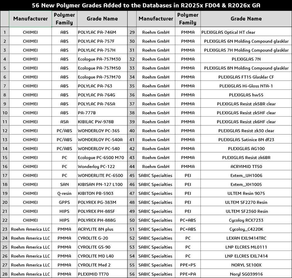

Perform accurate plastic injection simulations with the addition of 56 new polymer grades from the following manufacturers – CHIMEI (22 grades), SABIC Specialties (12 grades), Roehm GmbH (16 grades), and Roehm America LLC (6 grades).
