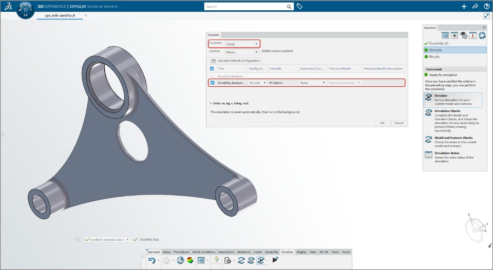

Durability solver now supports cloud compute to remove hardware barriers and enable any user in running large models on the cloud

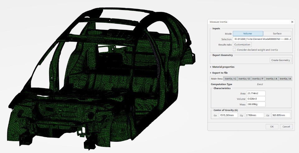

FEM integration in standard mass & inertia measurement tool, leveraging information available in Model Queries

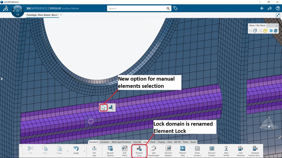

Meshing - New persistent locking options for elements and domains facilitating any remeshing action

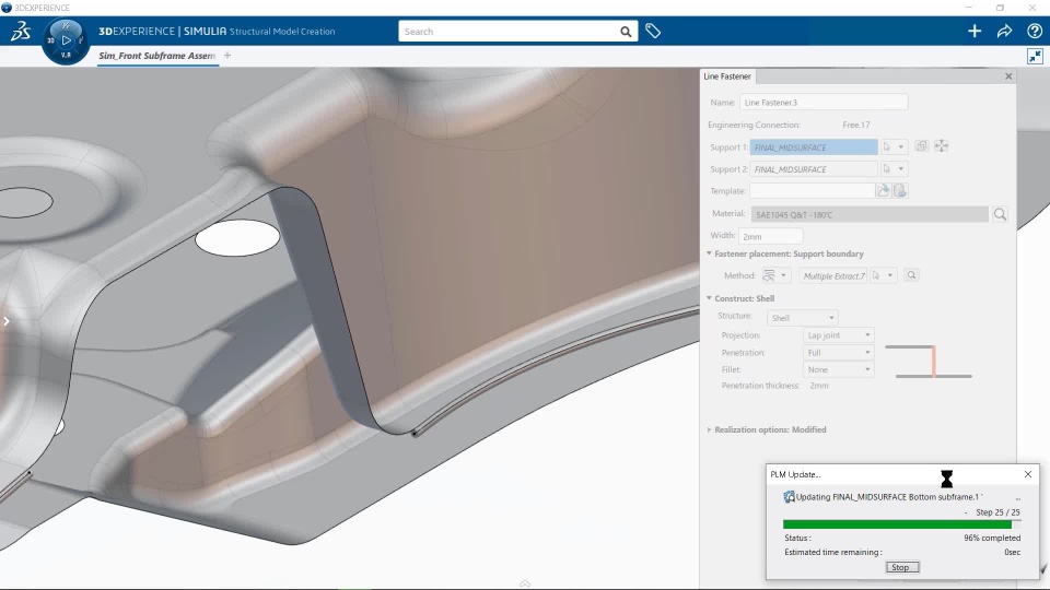

Modeling & Meshing -Support lap joint for the Support boundary method of line fastener reducing dramatically the time effort and effort to create the mesh in such case

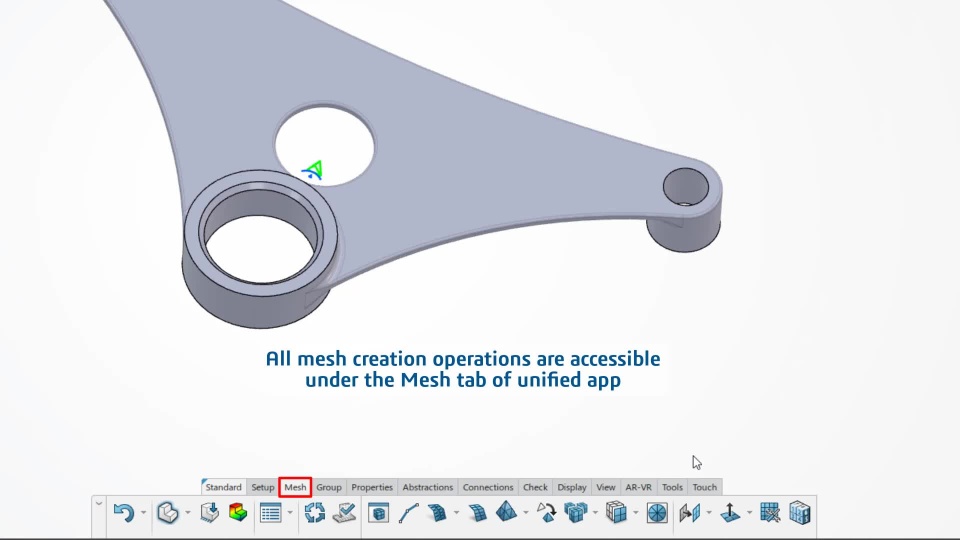

Improved model-build user experience with a unified app for meshing and structural model creation, improving efficiency
Modeling and Meshing -Support lap joint for the Support boundary method of line fastener reducing dramatically the time effort and effort to create the mesh in such case
Modeling and Meshing - New persistent locking options for elements and domains facilitating any remeshing action
