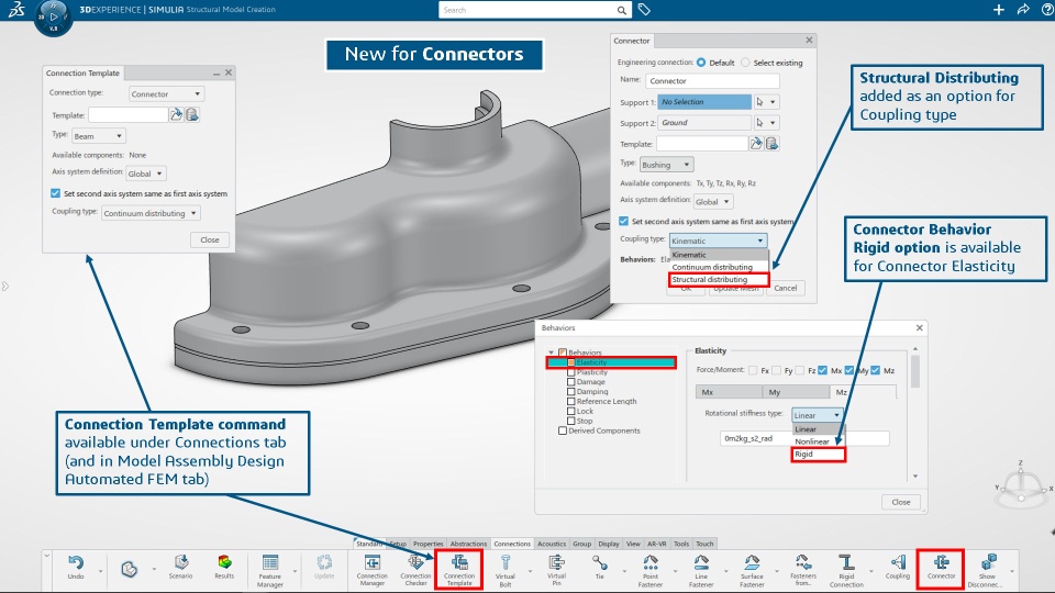

Modeling - New connection options (e.g. rigid elastic in connector behavior, distributing vs. kinematic couplings in connector and virtual bolt) to improve the connection modeling flexibility

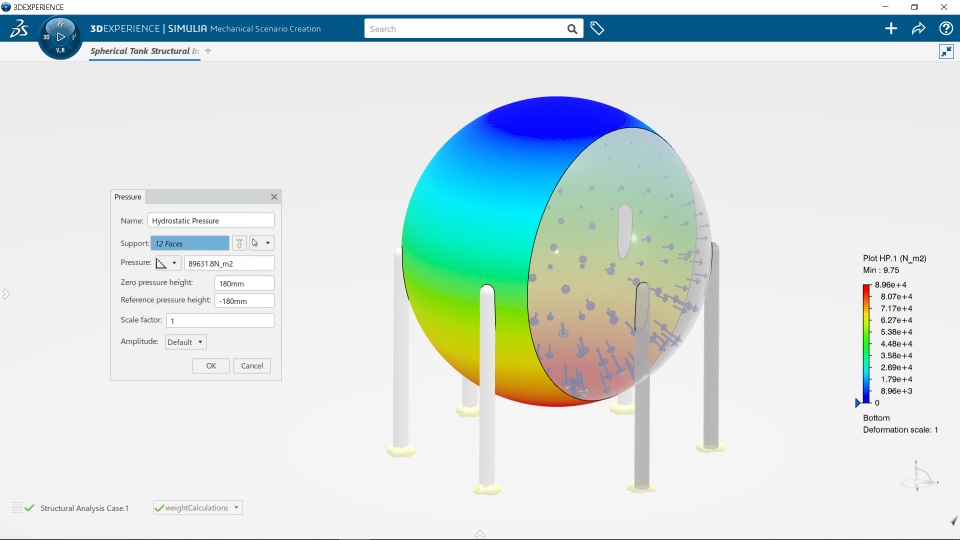

Scenario – Support of hydrostatic pressure, regular load condition for pressure vessel simulations

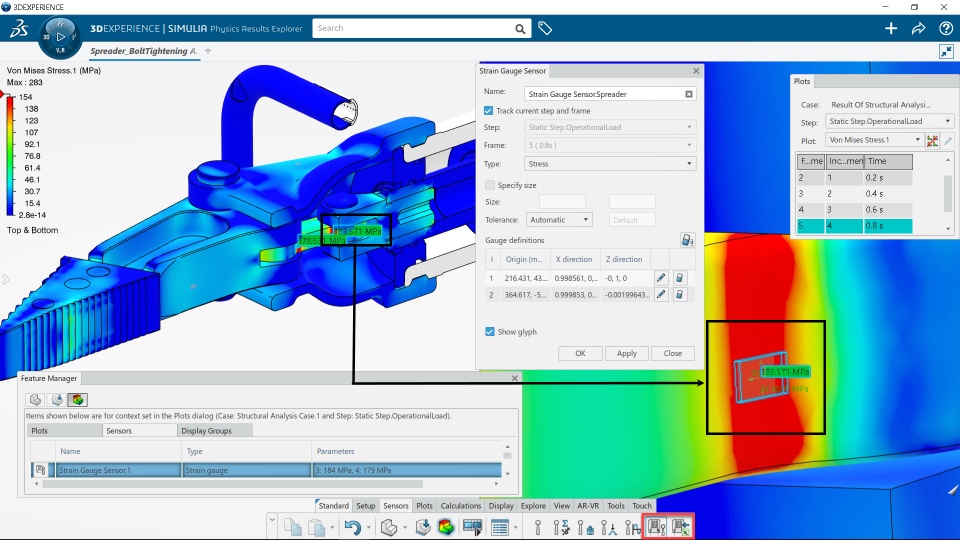

Post-Processing - Virtual Strain Gauge creation tool to define and output simulation results consistent with standard physical test measurement methods, and help determine best strain gauge locations for test

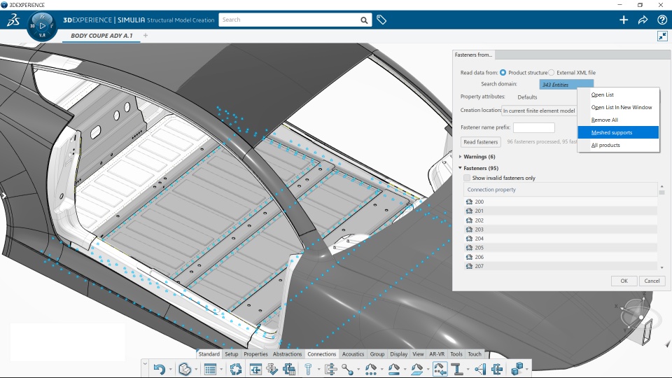

Modeling - More options (e.g. search domain) provided for the fastener creation automation using data coming from the CATIA Fastening app

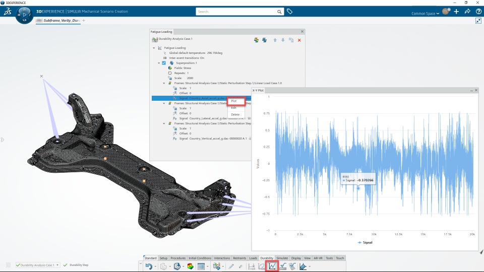

Durability - XY Plotting of Fatigue Loading Signals

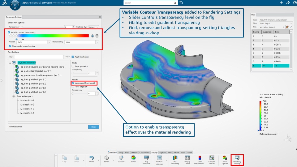

Post-Processing - New variable contour transparency for contour rendering enhancing rendering settings for results data review or communication
New options (e.g. search domain) to automate fastener creation using data coming from the CATIA Fastening app
Ability to provide semi contour rendering capability in Post Processing phase

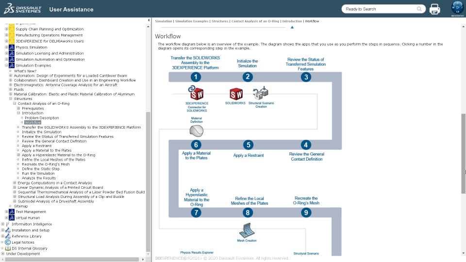

Deliver an example that uses the 3DEXPERIENCE Connector for SOLIDWORKS in the 3DEXPERIENCE Simulation Examples user guide.

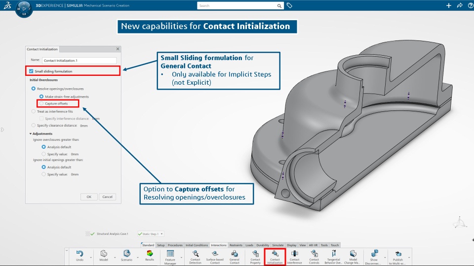

Small sliding in General Contact for faster contact set up in linear cases
