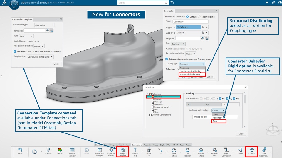

Modeling - New connection options (e.g. rigid elastic behavior, distributing or kinematic couplings with connector, and virtual bolt) to improve the connection modeling flexibility

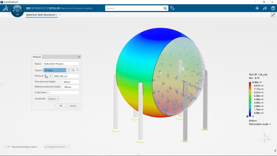

Scenario – Support of hydrostatic pressure, regular load condition for pressure vessel simulations

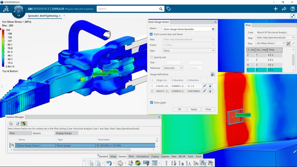

Post-Processing - Virtual Strain Gauge creation tool to define and output simulation results consistent with standard physical test measurement methods, and help determine best strain gauge locations for test

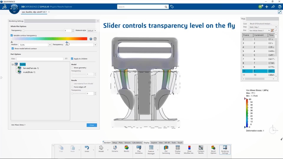

Post-Processing - New variable contour transparency for contour rendering enhancing rendering setting for results data review or communication
Modeling - New connection options (e.g. rigid elastic in connector behavior, distributing vs. kinematic couplings in connector and virtual bolt) to improve the connection modeling flexibility
