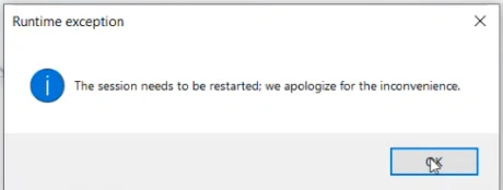

Runtime Exception:
Runtime Exception: The Session needs to be restarted; we apologize for the inconvenience
Probable Cause:
  • This error can occur either while launching the application or while performing any operation in the desktop app.
Probable Solution:
  • Check if the Graphic Card version is supported and if it is on the recommended version.
  • Click here to check the Certified Workstations.
