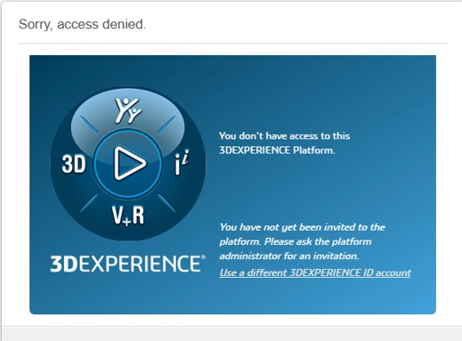

Sorry, Access Denied
You have not been invited to the platform, Please ask the platform Administrator for an invitation
Probable Cause:
  • As the error suggests, users face this problem when they are not invited on the platform.
  • You are not invited with the correct email address (look for typos)
Probable Solution:
  • User facing the issue should contact the administrator to be invited.
  • If he is already invited, then confirm the URL if it is the correct one. Check with Administrator for the correct URL.
  • Check if you are invited on the correct email address.
  • Remove the pending invitation and Re-Invite user

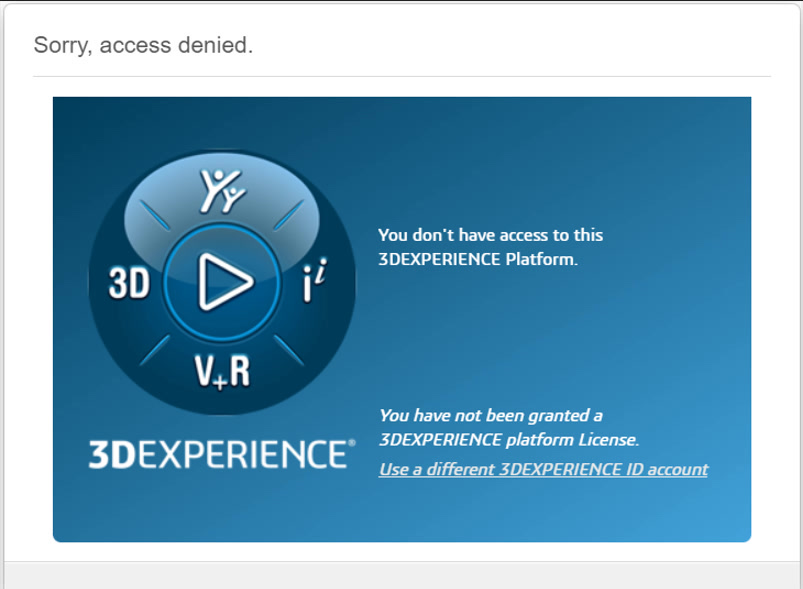

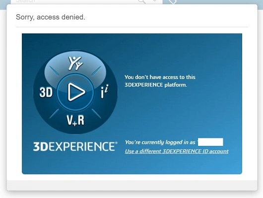

You are currently logged in as | You have not been granted a 3DEXPERIENCE License
Probable Cause:
  • First access to tenant through "Get Started" email (a.k.a. 'OTT link') has not been performed.
  • Your 3DSwymer license (IFW) is expired
  • This error usually occurs when the user is invited in Cross Company Collaboration. Cross company collaboration works when User 1 uses his license from Tenant A to login to Tenant B (Without consuming license on Tenant B)
Probable Solution:
  • To activate the tenant and consume the OTT user should use the link received in the first "Get Started" email.
  • Admin to make sure 3DSwymer licenses are valid
  • Confirm that user has Role and License assigned on at least 1 tenant. (Tenant A)
  • Make sure the option "Restrict Usage to this Platform" option is disabled on Tenant A

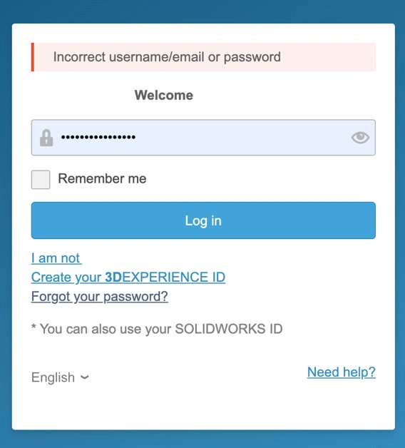

Error at Login
Incorrect username/email or Password
Probable Cause:
  • As the error suggests this problem occurs when 3DX cannot confirm the username and password
Probable Solution:
  • Double check if you are tying the correct password, confirm the email or username.
  • Confirm if you have created a 3DEXPERIENCE ID.
    If not use below link to create 3DX ID
    <a href="https://eu1.iam.3dexperience.3ds.com/login?#register" rel="nofollow">https://eu1.iam.3dexperience.3ds.com/login?#register </a>

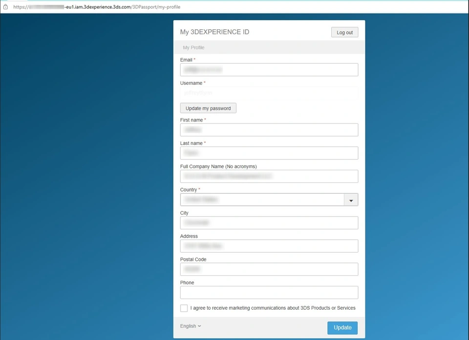

Log in stuck in Account information page, Cannot navigate to the platform. Clicking on Update does nothing
Probable Cause:
  • The URL being used to log in is incorrect. As seen in the screenshot, the user is using the "My Profile (eu1.iam)"  URL.
Probable Solution:
  • Connect to the 3DEXPERIENCE Platform on cloud URL:
    Public Cloud: <a href="https://eu1-ifwe.3dexperience.3ds.com/" rel="nofollow">https://eu1-ifwe.3dexperience.3ds.com</a>
    Academia Cloud: <a href="https://eu1-academia-ifwe.3dexperience.3ds.com/" rel="nofollow">https://eu1-academia-ifwe.3dexperience.3ds.com</a>
