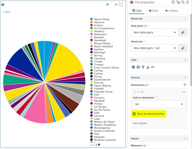

- In the Part-to-Whole and Distribution chart visualizations, you can use the option when to use hierarchical dimensions

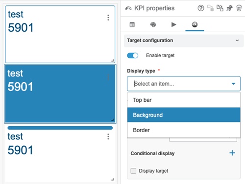

- Better readable KPIs status in Data Perspectives: KPI component will have now multiple configurations to show the status or alert of a KPI: Banner, Contour or Full card.

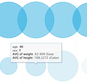

- In the Bubble Chart, you can now define Measures for the bubble size and the color

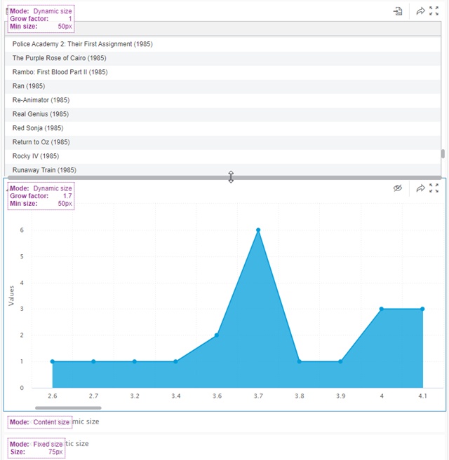

- In a Row Layout or a Column Layout container, you can now resize visualizations manually.
You can use this option for fields stored as List type. When you select this option, the visualization lets you browse on click through the dimension levels. The chart first shows the values of the first level of hierarchy in the dimension. On click, the chart shows the values of the second level etc... A breadcrumb allows you to return to a previous level as in a standard multidimension drill down.
You can now choose a predefined Display type to show your KPI indicator.
You can now define one measure for the size of the bubble, and another measure for its color. You can define the same measure for both the Size and the Color of the bubbles. In that case, the bubble tooltip shows the measure value only once. If you define different measures, the tooltip shows one line per measure.
In a Row Layout or a Column Layout container, you can now resize visualizations manually. Click and drag a visualization border (within the layout) until it reaches the required size. Purple rectangles appear at the top of each visualization in the container. They show the Size mode defined for the layout visualizations. If you applied: A Dynamic size, you see that the Grow factor changes when you resize the visualization. A Fixed size, you see that the Size in pixels changes when you resize the visualization.
