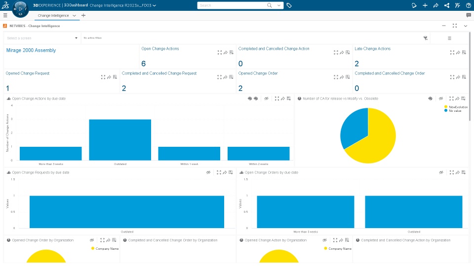

Starting R2023x_FD03, the product manager and change manager will be able to analyze, for a given product configuration:
- An overview of opened Change Requests and Change Orders linked to the Changes Actions opened on this configuration, their evolution over time and the distribution of CO and CA per organization in order to better prioritize the effort.
- Investigate the completed and cancelled Changes (Change Actions and their related Change Requests and Change Orders) to ensure traceability and a complete view of all the Changes.
