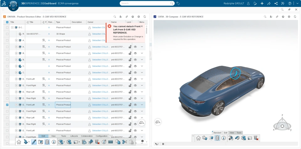

Ensure the Parameterized Console option "Force Work Under for Configured Structure" is enabled to enforce this behavior
Forcing work under
If enabled, performing a structure modification without Work Under Evolution authoring mode will trigger an error message and prevent executing the modification.
If enabled, performing a delete , insert or any other alteration  without Work Under Evolution authoring mode will trigger following error message.
As soon as the user switches to Work Under Evolution authoring mode, the operation can be completed successfully.
After switching with work under, user can successfully perform the modification in the configured structure
