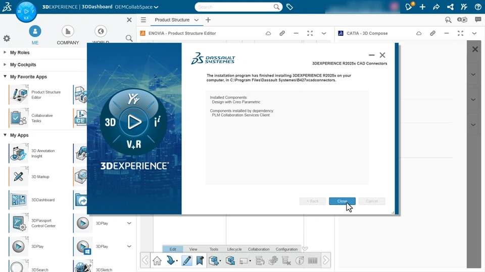

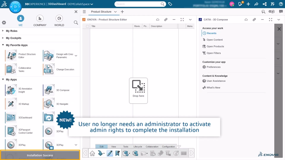

The installation process has been simplified by removing the need for elevated privileges thereby reducing the burden on IT resources and enhancing the user experience.
Administrator right are no longer needed to install Design with Creo Parametric

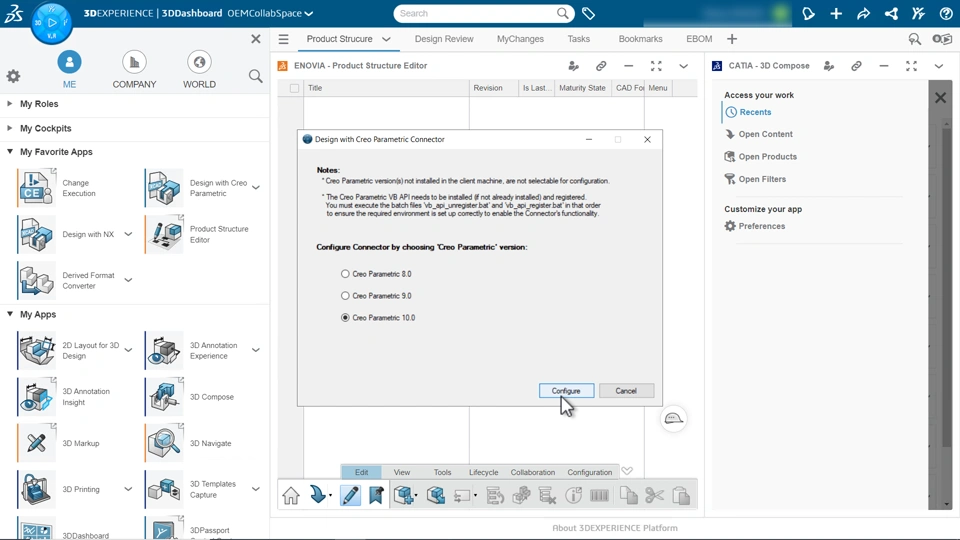

Choose supported version of Creo Parametric to complete the installation
Select OK to register the configuration

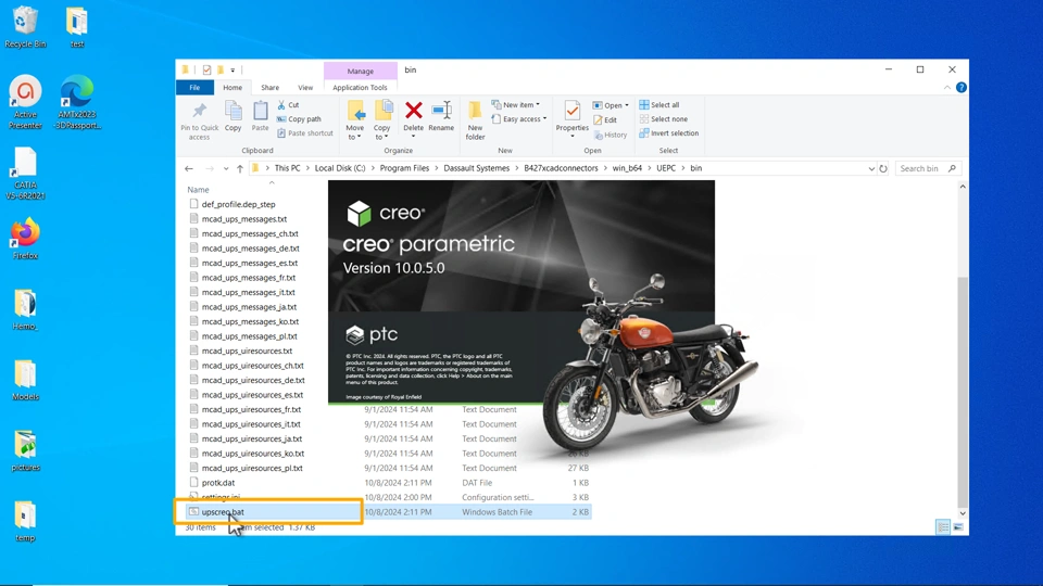

Launch the Launch the Design with Creo Parametric client by selecting the upscreo.bat file located in the installation directory
