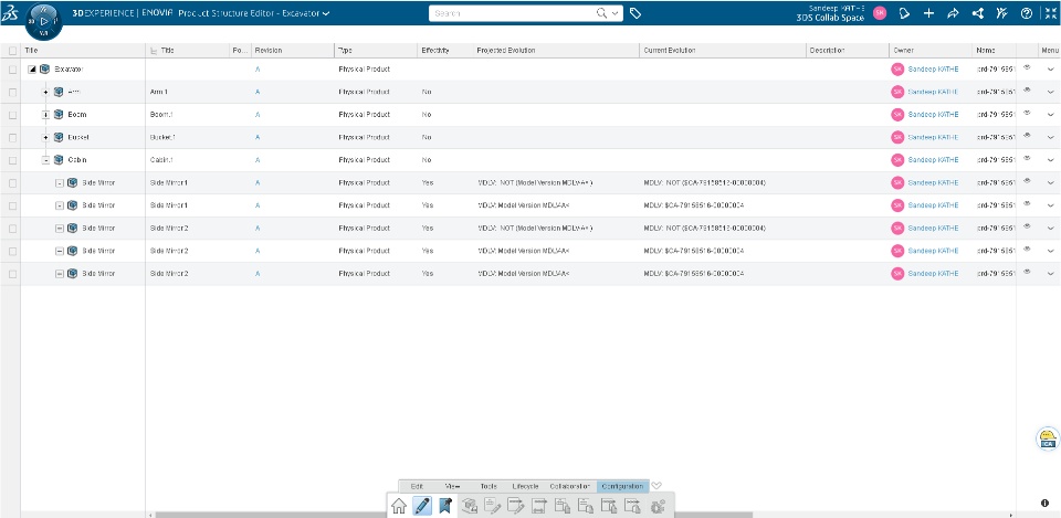

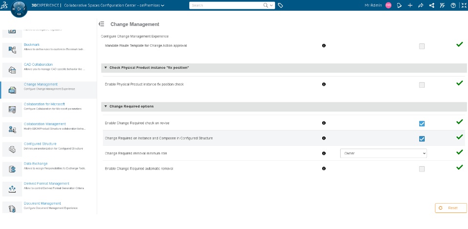

Improve traceability of changes on instances by allowing users to set any instance under change control to ensure all modifications are captured and traceable on the realized items.
Users working under a change action for configured structures will now be able to track all the instance modifications under change control

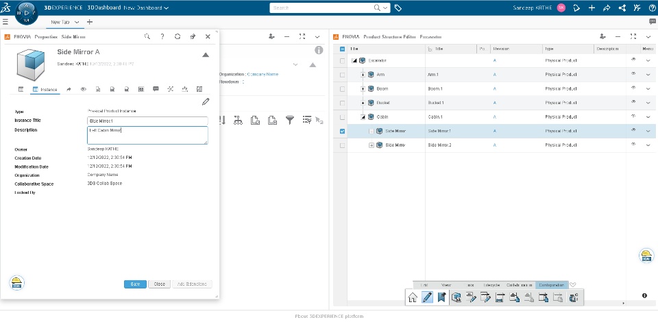

Activating work-under on the instance will capture applicability modifications on the change action realized traceability log.

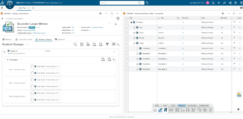

Change Action will capture the modifications done under the realized items

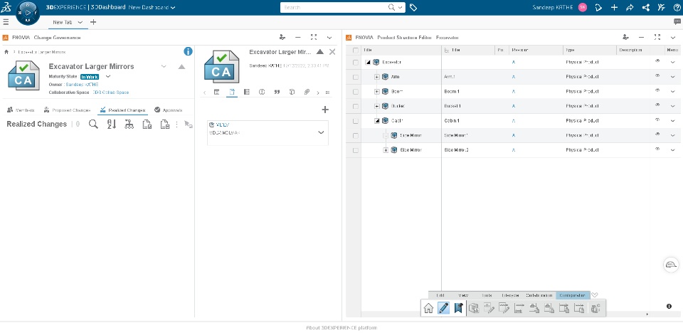

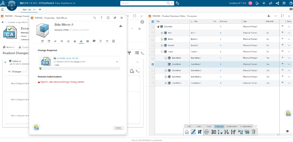

Instance properties page will also show the change actions that have been raised against the instance
