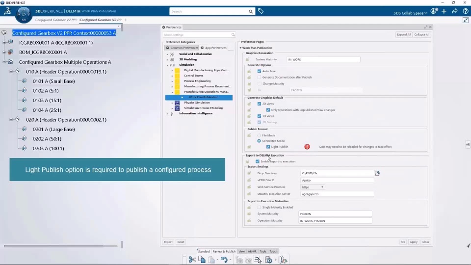

When dealing with configured Process and Work Instructions (same Process structure for multiple variants & options, evolutions), it is now possible to publish it and resolving at review or execution purpose. It is not anymore required to resolve it before publication.
In Work Instructions Definition, a new option in the preferences allows to activate the “light publish” mode, which does not anymore generate a “published product”, and so allows to deal with configured process and 3D work instructions. It saves as well some time at publication step.

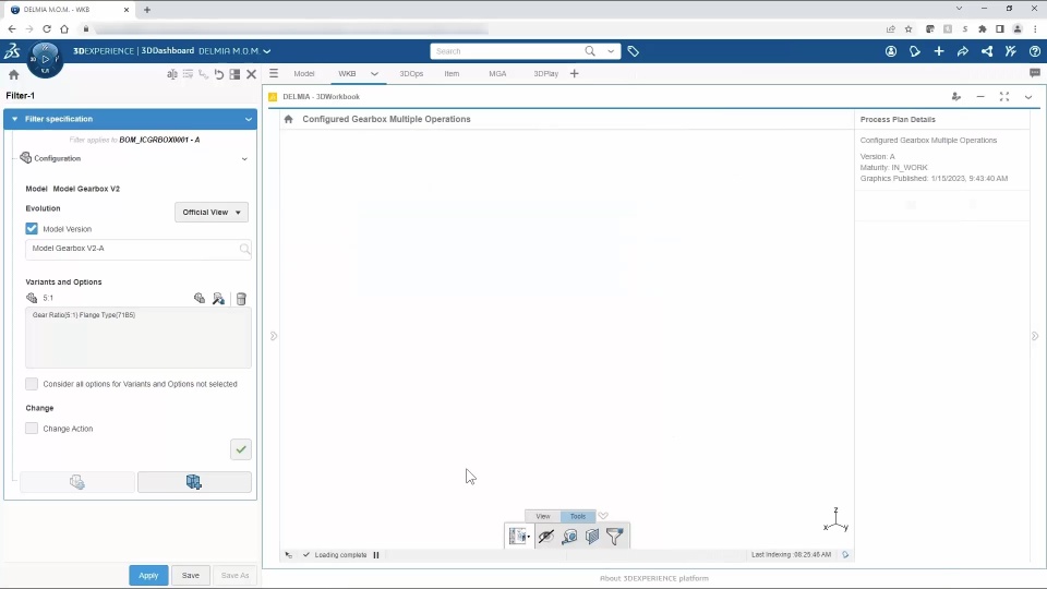

When reviewing a process (Workplan or General System) in 3D Workbook application (part of PMR or WKB roles), if there is some configuration model associated to it, the system will automatically propose the user to apply some filtering criteria before opening it. Content will then be resolved on the fly for both process content and 3D data.
