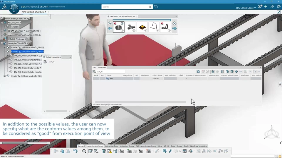

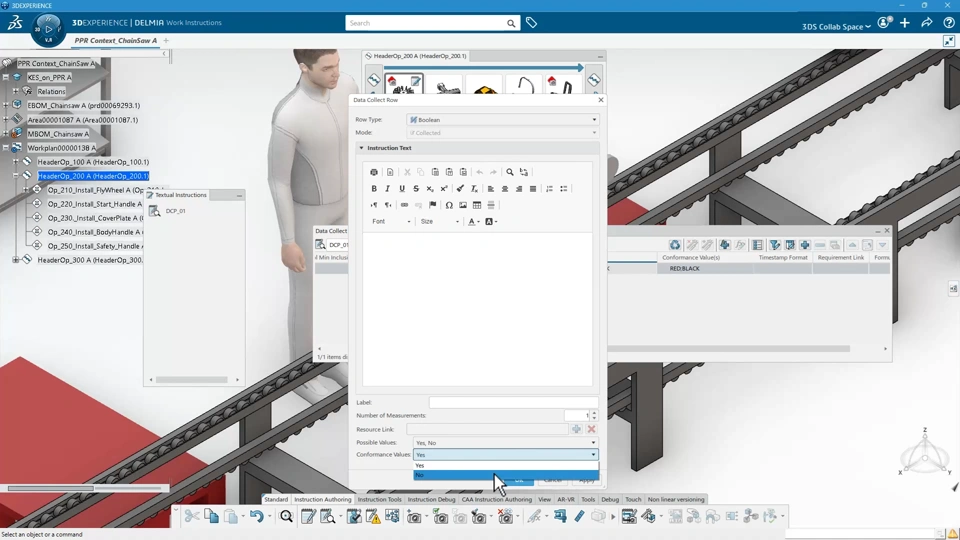

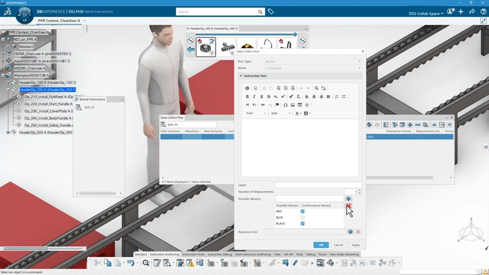

Improved data collect plan definition with conform values specification for execution
Conform values for text
Conform values for boolean

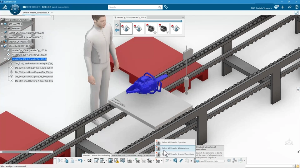

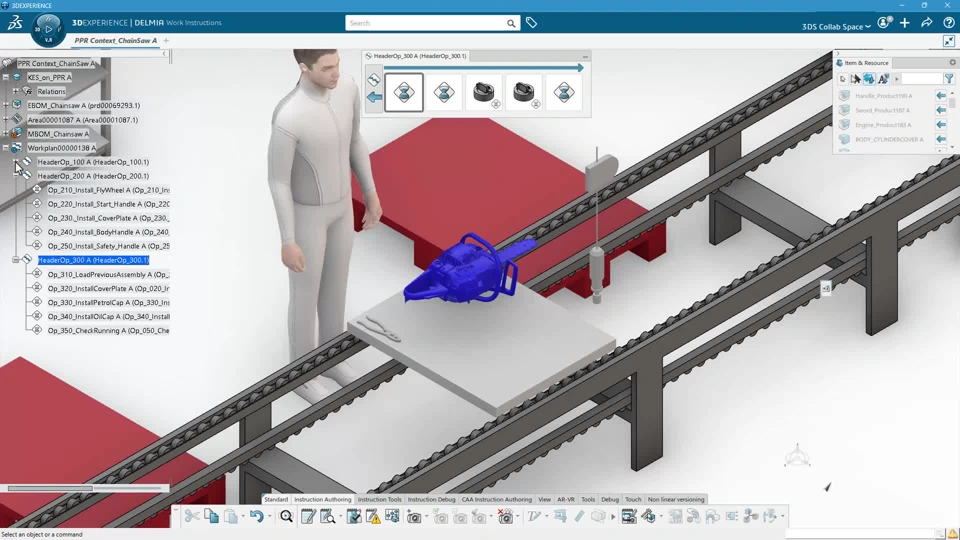

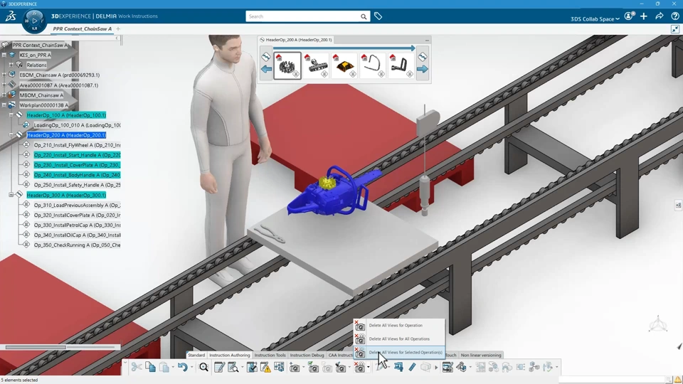

New commands to manage massive deletion of views in one click
Delete all views for all operations (of active Workplan or Header Operation)
Deleted all views of selected operations

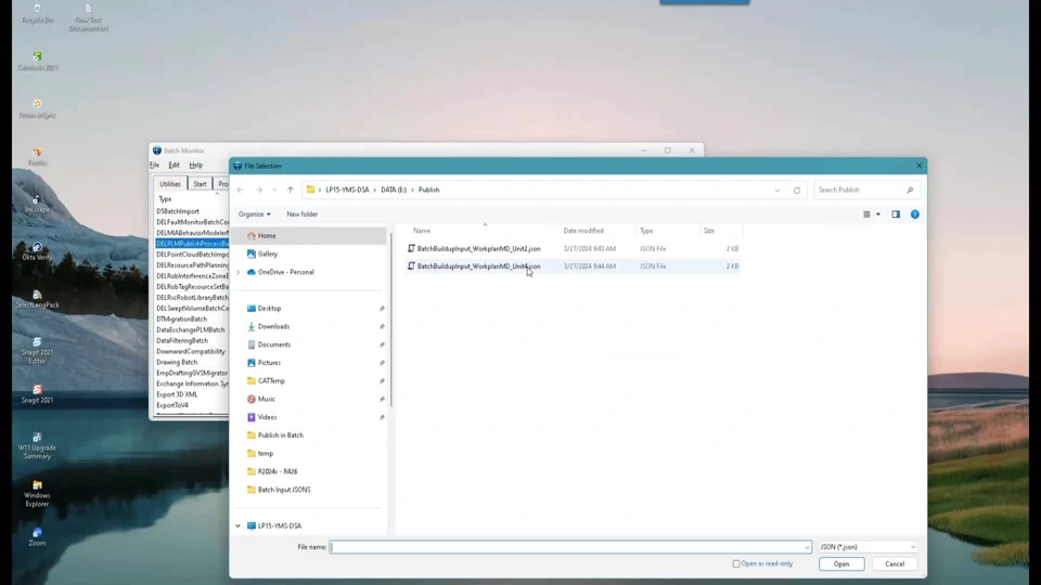

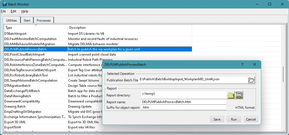

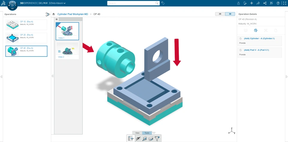

User will be able to generate a publication for a Workplan in batch mode for a dedicated Unit. Batch will be run by the customer when they want (could be every night, based on a retro-planning before execution, when work order is created in the ERP etc.).
The Batch is available through Batch monitor capability

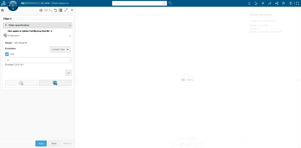

At review (in 3DWorkbook app) the published data generated for the Unit (if exists) will be used when reviewing the data for the filtered Unit.
Process and related work instructions items and views will be displayed according selected unit
