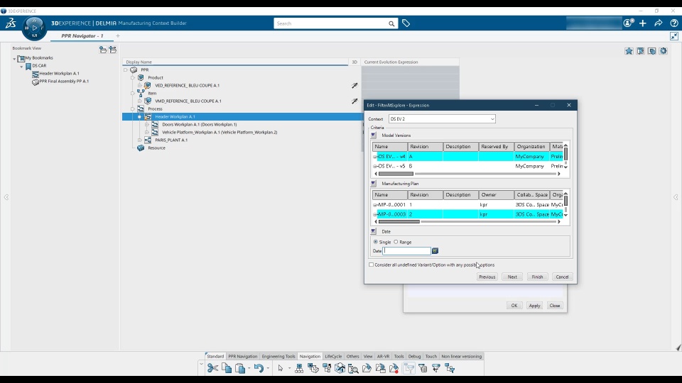

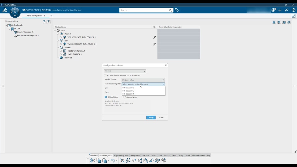

Simplify working session preparation and enhance user experience by applying a common configuration filter (Model Version, Manufacturing Plan, Builds or Dates) in the Manufacturing Context Builder (MCB) app.
- One command provides a consistent methodology when working with multiple data structures
- Create and apply the configuration filter on all nodes – Product, Manufacturing Items, Process and Resources with one click
Demonstration video of the new enhancement of Manufacturing Context Builder application (MCB)

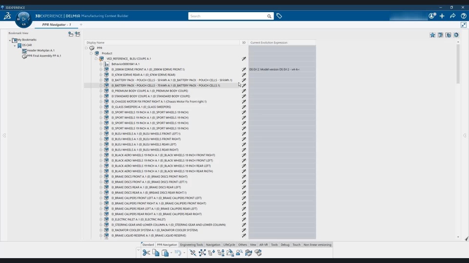

At PPR data explore a new Panel will automatically pops up if there is any associated Configuration Evolution set on any structure.
The command will automatically generate filters on each applicable structure. These filters can then be edited and enriched if needed.
