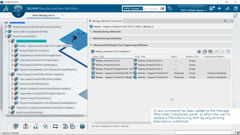

- Validate and select Alternates / Substitutes parts with a replace by alternate capability

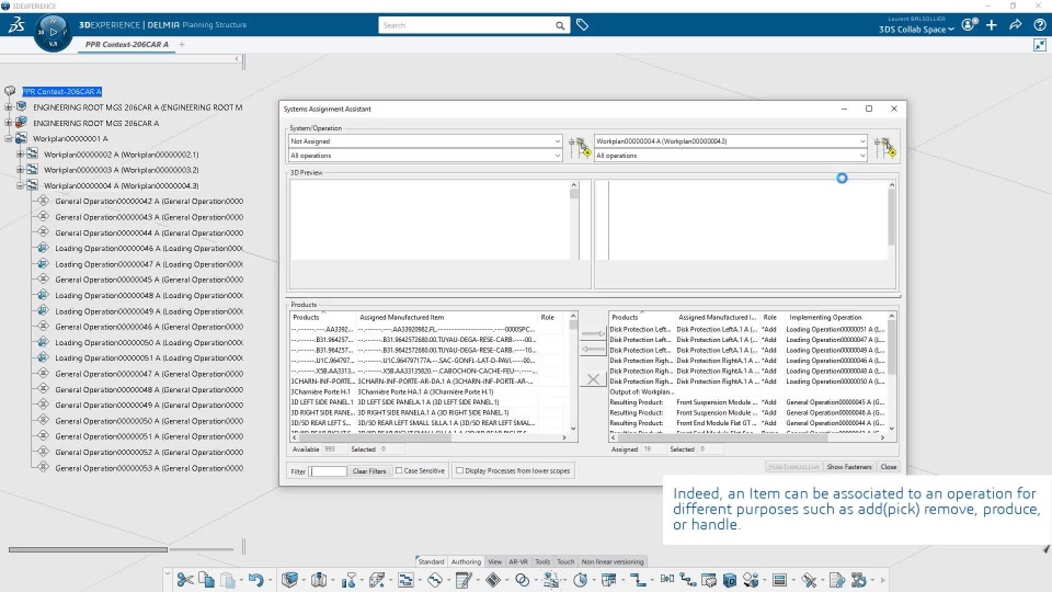

- Define the usage at manufacturing items consumption (pick, place, move, remove, etc) by operation

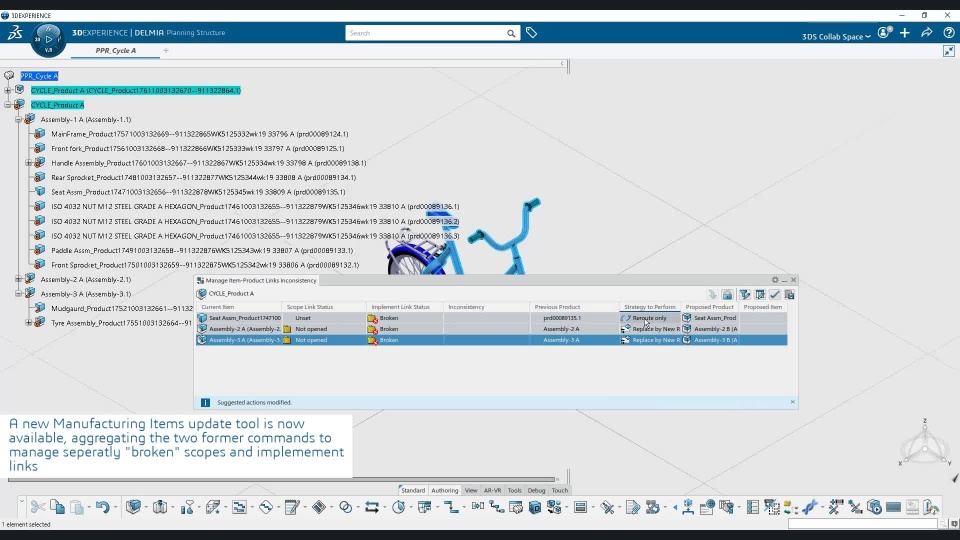

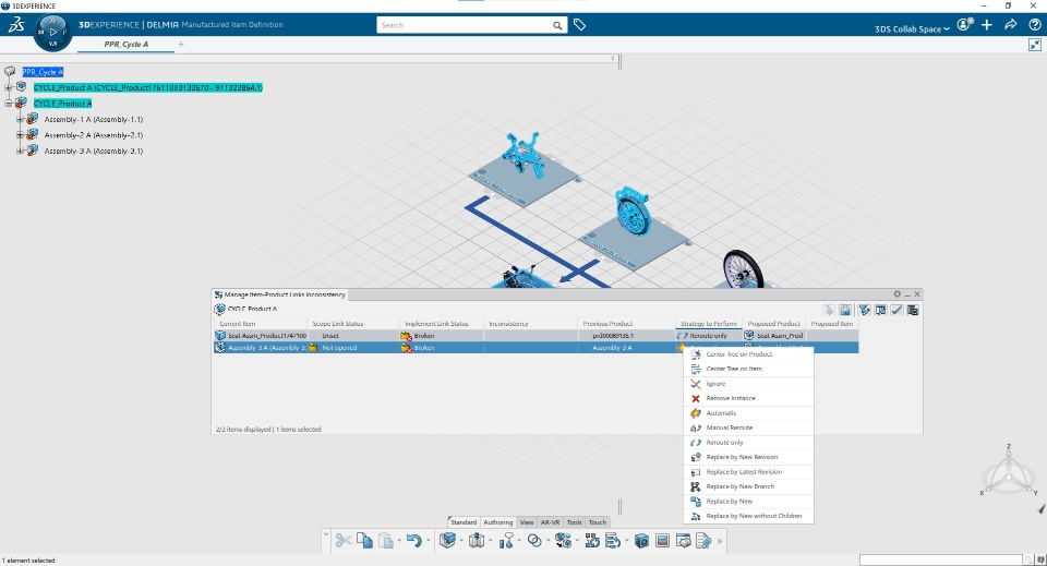

Shorten the process of defining the Manufacturing Bill of Materials by automating non-value-added user interactions with a single, combined command (manage inconsistent scope & manage inconsistent link) that administers the updates at multiple levels.
New unified tool to manage all kinds of Product structure (EBOM) impacts on Manufacturing Items structure (MBOM)
Former tools to manage inconsistent scopes and inconsistent implement links between Products and Manufacturing Items are now merged in one single tool to fully manage all Product changes impacts on Manufacturing Items structure
New command to replace a selected Manufacturing Item by any existing alternates or substitutes defined on associated Engineering Item

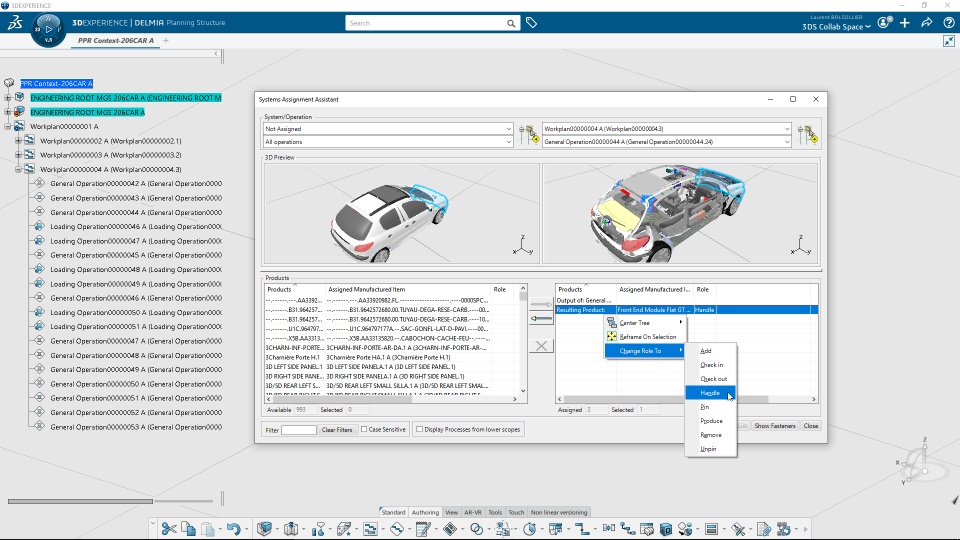

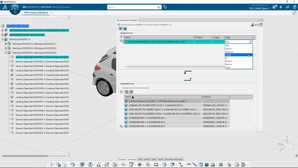

When assigning Manufacturing Items to Operations, it is now possible to specify a role to reflect the purpose of this association, such as : add, remove, handle, etc.
Some default role will be define based on the types of Manufacturing Items and Operations. This role value will be editable in the Assignment Manager.
The role value will also be editable in the Systems Assignment Assistant.
