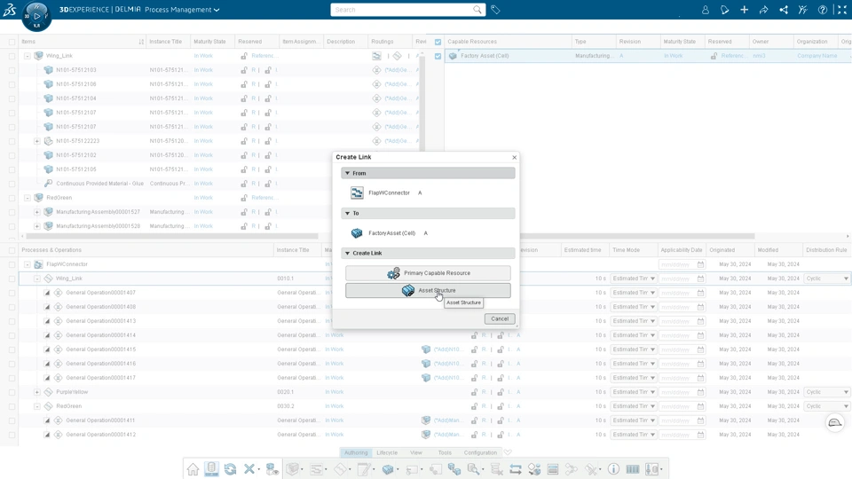

- Ensure consistent process definition for scheduling and execution by specifying targeted production sites with dedicated link (factory assets link)

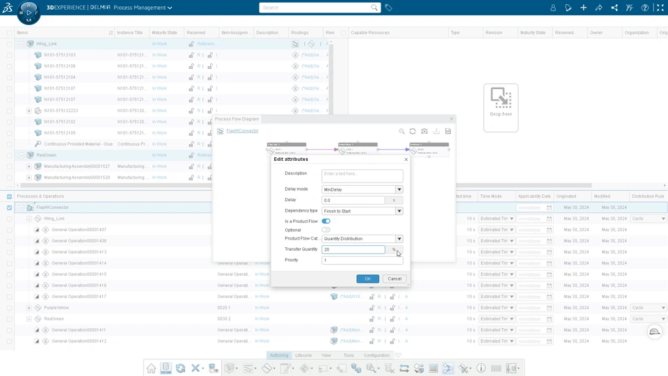

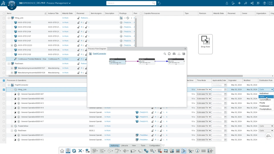

- Improved quantity management and ease overall manufacturing process definition by supporting quantity distribution across process flows (from one operation to a next one, the quantity percentage of material being transferred can specified, in case of split between different parallel steps, for example)
A new "Quantity Distribution Flow" type is introduce to split quantities produced by an operation in different sub-sequent operations, with ratio of transfer quantity (ratio in % of total quantity produced by the operation) and priority (integer > 0) on the product flow, and a distribution rule on the operation instance. Quantity distribution between Operations through product flows following pre-defined distribution rules. Ensure continuity with scheduling and execution by specifying factory assets links with manufacturing processes (Associate Process with Factory Assets).
