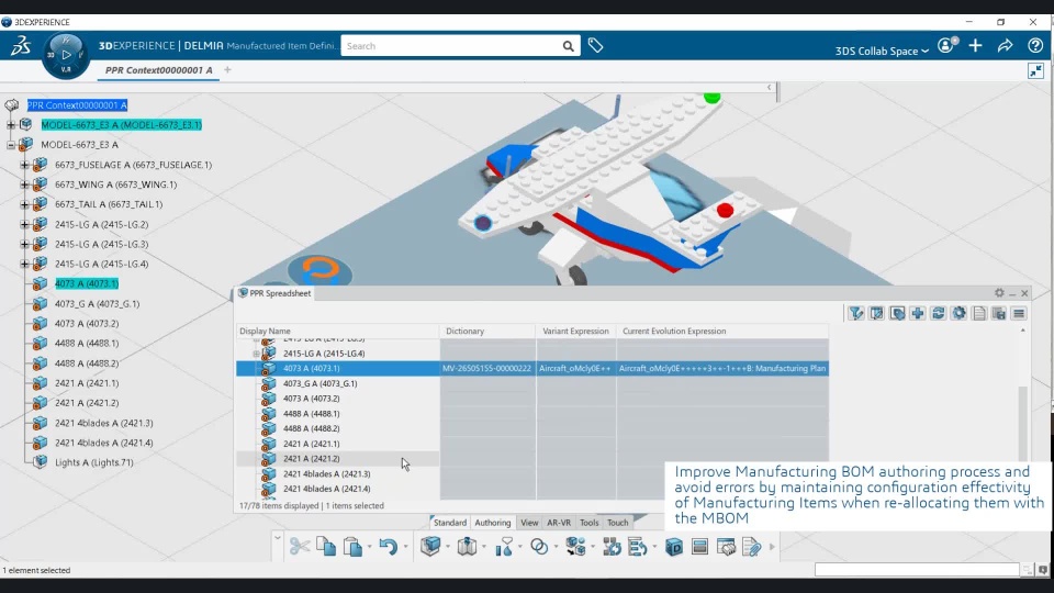

Eliminate time-consuming manual tasks and prevent errors by improving the authoring process for MBOM restructuring. Maintain the BOM integrity when re-allocating or restructuring without losing important configuration data (such as variants and options, evolutions, units, or related dates)
When restructuring the Manufacturing BOM by drag and drop any existing effectivity will be maintained

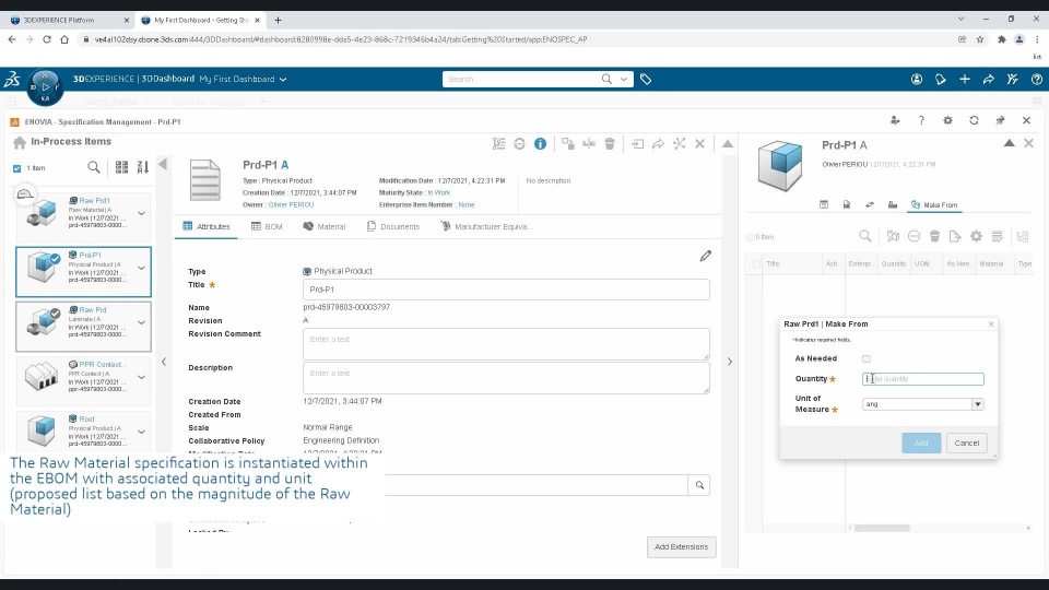

Raw Material specification with or without quantities (for discrete or non discrete Raw Materials) will be managed within the Product structure and exposed to Manufacturing with a new relation (“Made From” for a Product to refer to another Product / Raw Material item). This Raw Material information will be leveraged and mapped within the Manufacturing Items structure either: as a Provide for discrete Raw Material or as Continuous Manufacturing Items with quantities for non discrete Raw Material.

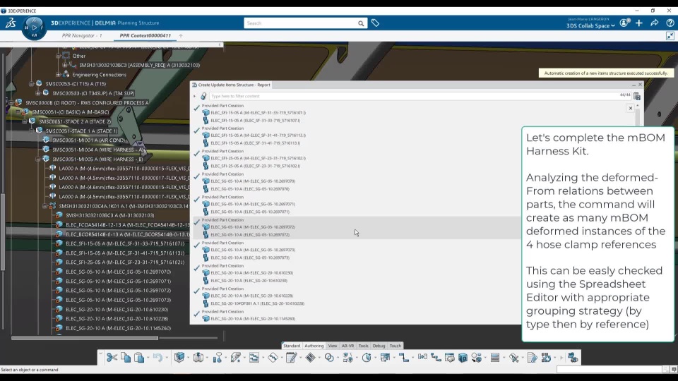

Manage Deformable Parts specification input from Engineering BOM to be consumed in the MBOM Leverage “deform from” relationship from Engineering BOM to retrieve and consume directly original non deformed item Usage of the same Manufacturing item reference whatever the deformed representation Defined your Process & Work Instructions on top of a consistent Manufacturing BOM (one single reference for all deformed representations)

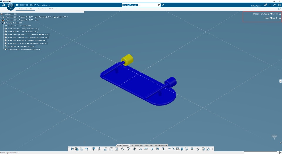

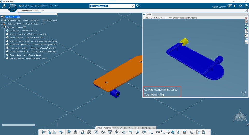

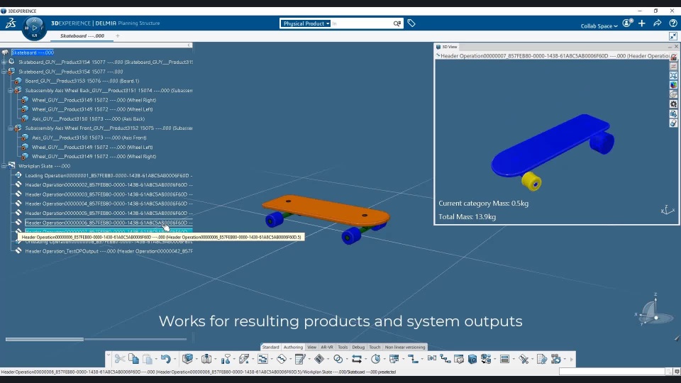

Visualize the weight of your Product for each Manufacturing Assembly and at each step of the Process sequence (preference option) According to weight information of Engineering items associated to Manufacturing Items With distinction of 3 categories : current items ,removed items and total mass
Within the main view in “Review mode” in Planning Structure application.
Within 3D Viewer
