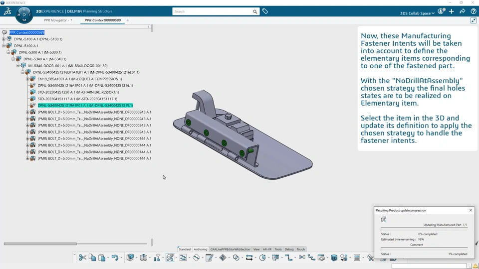

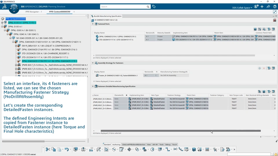

Leverage drilling and torque design engineering specifications for Manufacturing Engineering, by generating appropriate Fasten & Detailed Fasten Items, allowing to consume and trace propagation down to process and work instructions and leverage for downstream usage:
- Ensure process definition consistency by using a consistency check tool to identify discrepancies in terms of fastening strategies
- Ability to associate detailed manufacturing fastening strategy (eg. manage pre-drill and drill, fastener constituents...) for each fastener on a given bundle and provide the right granularity to define associated Work Instructions
