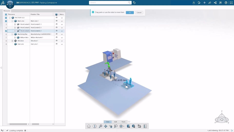

Intuitively manipulate resources in the 3D environment to quickly build a factory layout with the enhanced user experience:
- An easy snapping capability
- Align one or more 3D resources
A brand new user experience to move and manipulate the 3D objects in the 3D viewer through a Snap & Align capabilities.
Snap: When resource is moved in the 3D Viewer, as it comes into proximity of any other resource, the best possible snapping option is detected by the system and the moving resource is fit with the target resource. It is an action to meaningfully close or fit in place any two 3D resources. Align: An alignment line is displayed between the two resources and the minimum distance between the two resources is displayed to help user make a decision to appropriately place it. It brings into line any two 3D resources so that they are positioned logically.
