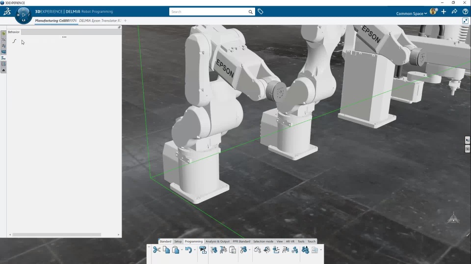

Save time programming Epson robots by utilizing the new offline programming translator. Use the translator with all Epson robots available in the DELMIA Robot Library
New EPSON translator

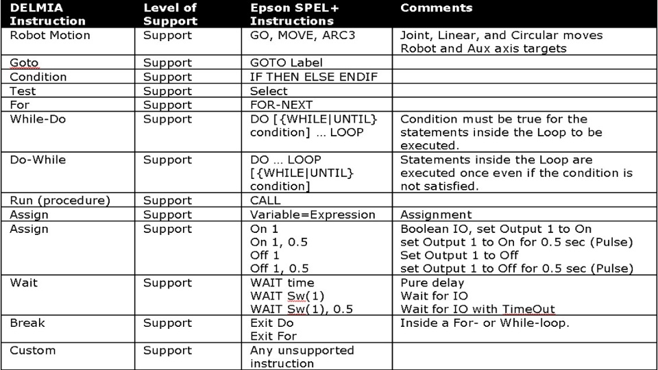

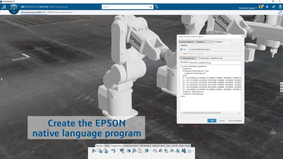

EPSON translator download or upload 3DEXPERIENCE robot tasks into EPSON Robot program in native SPEL+ language. The EPSON SPEL+ programs consist of logic program files (.PRG) and target definition files (.PTS)
List of the supported EPSON instructions
