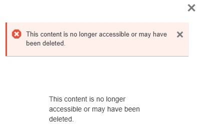

"This content is no longer accessible or may have been deleted" when checking properties of the object.
Probable Cause:
  • The error message "This content is no longer accessible or may have been deleted." can occur when checking the properties of the object if the option "Allow users read permission based on all the user's credentials, not only the active credentials (deactivation not recommended)" is disabled in Collaborative Spaces Configuration Center.
Probable Solution:
  • Enable option ""Allow users read permission based on all the user's credentials, not only the active credentials (deactivation not recommended)" is disabled in Collaborative Spaces Configuration Center.
    "Platform Management >> Content Tab >> Collaborative Spaces Configuration Center >> Permission Rules >> "Allow users read permission based on all the user's credentials, not only the active credentials (deactivation not recommended)"
  • For user assistance please click here
  • Please also check the Knowledge Article: QA00000417725

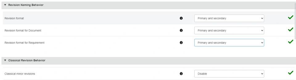

Settings Not Yet Applied or has Failed
Collaborative Spaces Configuration Center > Lifecycle And Collaboration > Revision Naming Behavior
Probable Cause:
  • Issue happens when a user tries to update the "Revision format" to the "Primary and Secondary" option when having the "Classical minor revisions" option in the "Classical Revision Behavior" section enabled.
Probable Solution:
  • To change the "Revision format" to "Primary and Secondary" the user will need to set the "Classical minor revisions" option in the "Classical Revision Behavior" section to "Disable".
Collaborative Spaces Configuration Center > Lifecycle And Collaboration > Classical Revision Behavior
Probable Cause:
  • Issue happens when a user tries to update the "Classical minor revisions" to the "Enable primary and minor revision format" or "Enable primary and minor revision format and creation" option when having the "Revision format" option in the "Revision Naming Behavior" section set to "Primary and secondary".
Probable Solution:
  • To change the "Classical minor revisions" to the "Enable primary and minor revision format" or "Enable primary and minor revision format and creation" the user will need to set the "Revision format" option in the "Revision Naming Behavior" section to "Primary".
