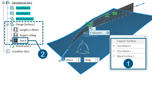

Automatic Join for OmniShape Supports For an OmniShape input curve or edge, you can select multiple support surfaces (). From the selected elements, a join is created automatically (). Benefits: The enhancement simplifies and facilitates the modeling process by eliminating the need to create joins manually. The support surfaces must meet the required G0 continuity tolerance.

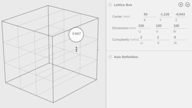

Creating Lattice Boxes You can create a simple faceless mesh defined with vertices and edges and dedicated to manipulation. From the Sketch & Shape section of the action bar, tap Lattice Box Creation . Benefits: You can simplify the modification process for complex geometry using a customized box. You can also precisely control modifications to fit specific requirements.

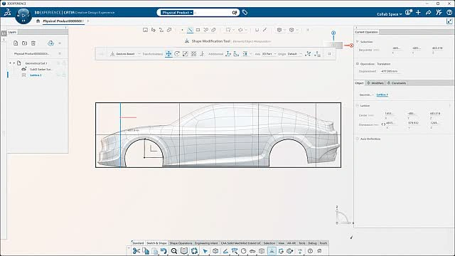

Creating Box Deformers You can create a box deformer by associating a lattice or a lattice box to an object. In the Constraints tab, tap Box Deformer . Benefits: You can modify a complex shape with a simple box thanks to this new constraint.
