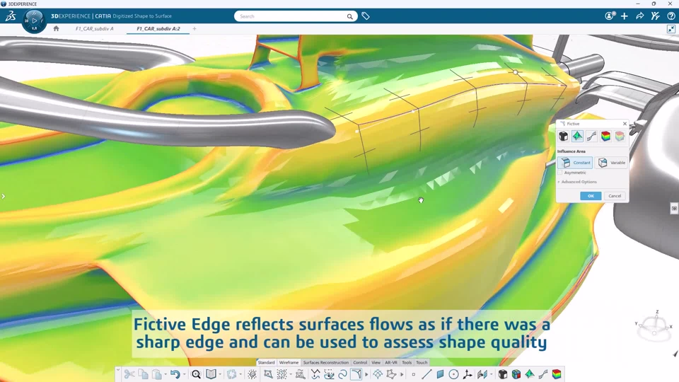

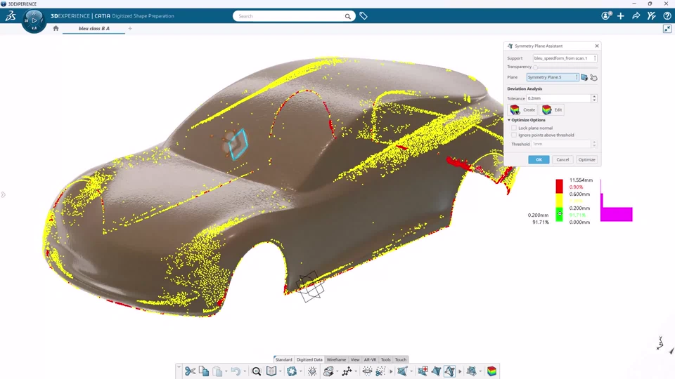

Accelerate repositioning of a scan detecting quickly its symmetry plane(s) in Digitized Shape Preparation. Easily retrieve a character lines from any shape thanks to Fictive Edge new extended scope, able to regenerate sharp edges from a meshes, but also now from subdivision or nurbs surfaces too.

Defining a symmetry plane: the Symmetry Plane Assistant command is now available to assist you in the symmetry plane definition for a mesh. You can ask for a proposal or provide your own initialization, then assess its accuracy and optimize it automatically.
Fictive Edge new support allowed: the Fictive Edge command can now be used on various supports like exact surfaces, subdivision surfaces, polyhedral data in addition of meshes and has been revamp to make it more consistent with other CATIA commands. The Show/Hide Curvature Map option is also now available.
