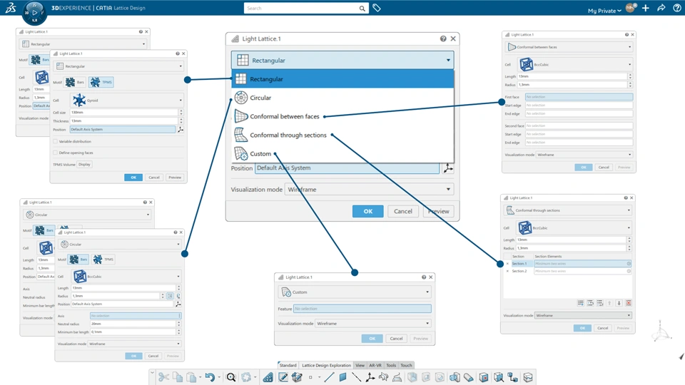

1. More comprehensive access to the replication modes in the Light Lattice command: Rectangular, Circular, Conformal between faces, Conformal trough sections, Custom.

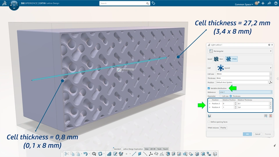

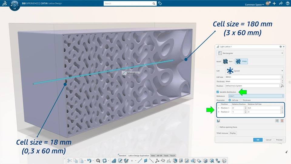

Video showcasing how to fine tune the distribution of the material of a triply periodic minimal surface lattice structure thanks to a new option Variable distribution
The picture shows a variation of the size of a Gyroid unit cell size along the curve highlighted in light blue. The Relative Cell Size ratios are applied to the Cell Size at the extremities of the Reference (Line.1). The thickness of the Gyroid remains constant.
The picture shows a variation of the size of a Gyroid unit cell thickness along the curve highlighted in light blue. The Relative Thickness ratios are applied to the Cell Thickness at the extremities of the Reference (Line.1). The cell size remains constant.
From Left to Right: Cell Thickness variation of a Gyroid Lattice, Cell Thickness variation of a Diamond Lattice, Cell Size variation of Gyroid lattice
The Light Lattice panel is fully redesigned in release R2025x. The picture shows the new panel in release R2025x and the corresponding panels of each replication modes.

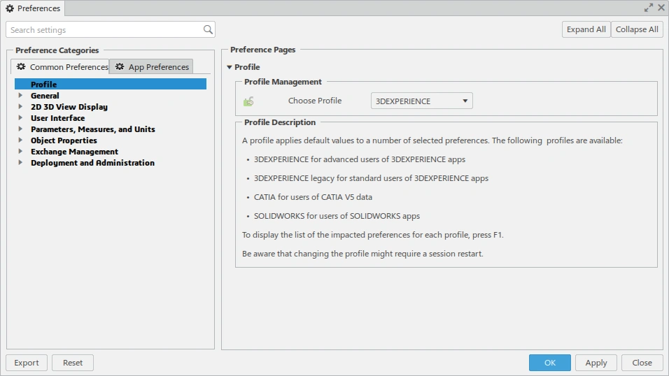

3. Get the full power of 3DEXPERIENCE with new default settings, taking advantage of the latest developments and improvements. This new set of settings is stored in the updated 3DEXPERIENCE profile.
