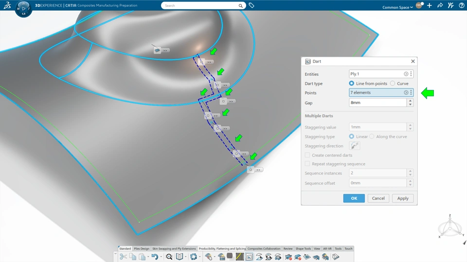

1. Manage complex manufacturing notches thanks to the dart command now allowing multiple points or an explicit curve as geometrical input.

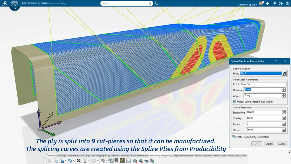

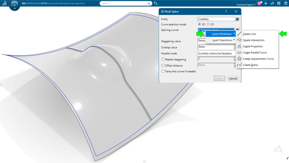

2. Streamline the creation of cut-pieces thanks to the ability to create splicing curves directly from the 3D Multi splice command.

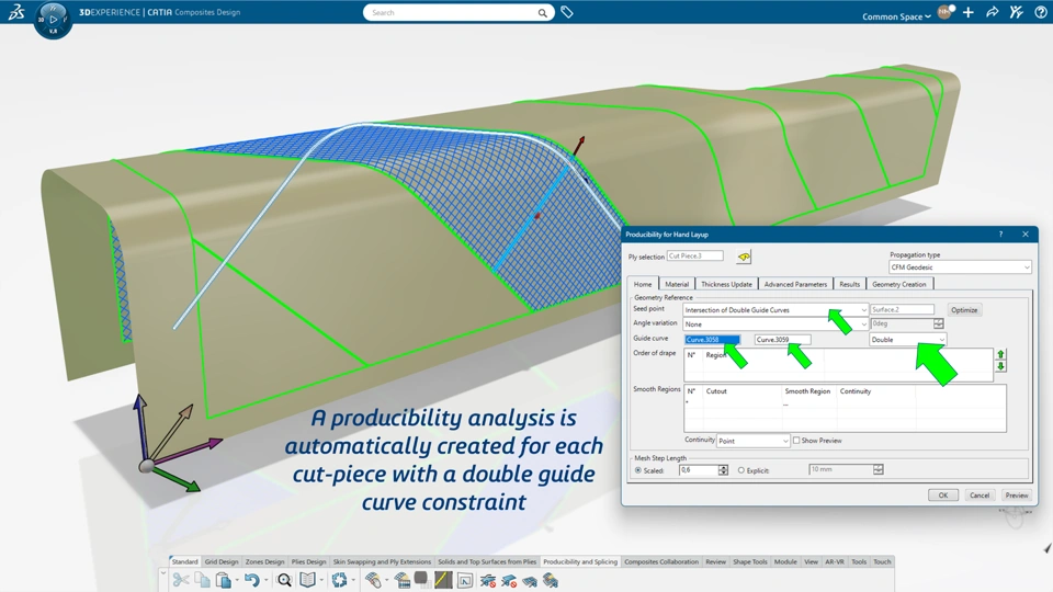

3. Ensure a proper fiber alignment of cut-pieces of plies with the automatic creation of producibility with double guide curve.

Quick and easy creation of complex darts with on-the-fly geometry creation or polyline creation with indication points
On-the-fly creation of input wireframe geometry in the 3D Multi Splice command
Automatic alignment of the splicing curves along the fiber direction
Automatic producibility analysis creation for each cut-piece with a double guide curve constraint
