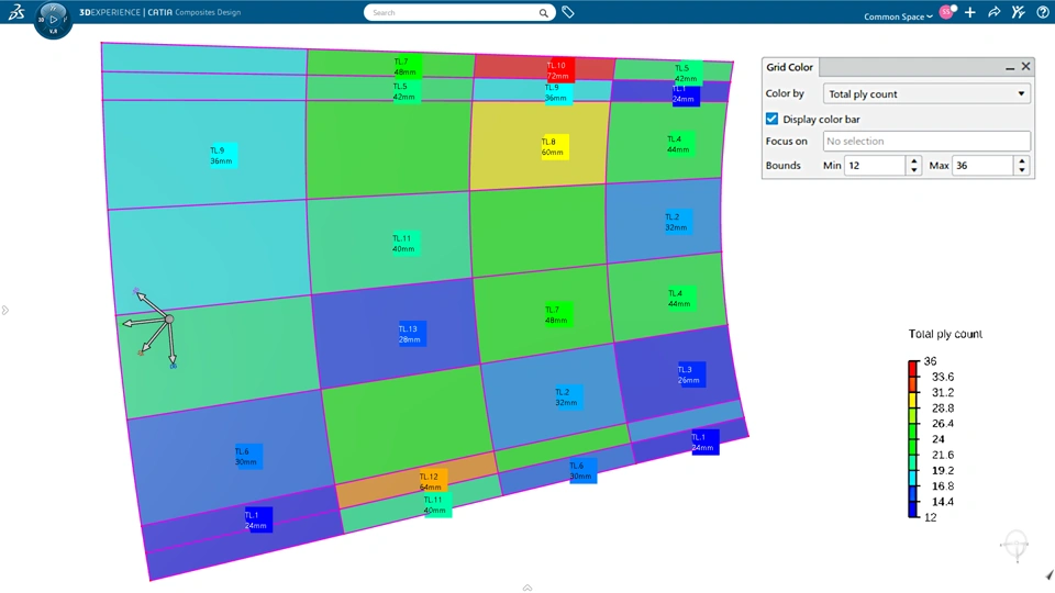

3. Enrich the grid design process with the ability to display information on the grid with a colorization of the cells

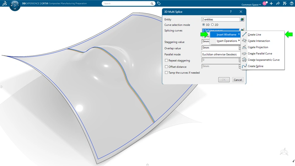

5. Streamline the creation of cut-pieces thanks to the ability to create splicing curves directly from the 3D Multi splice command

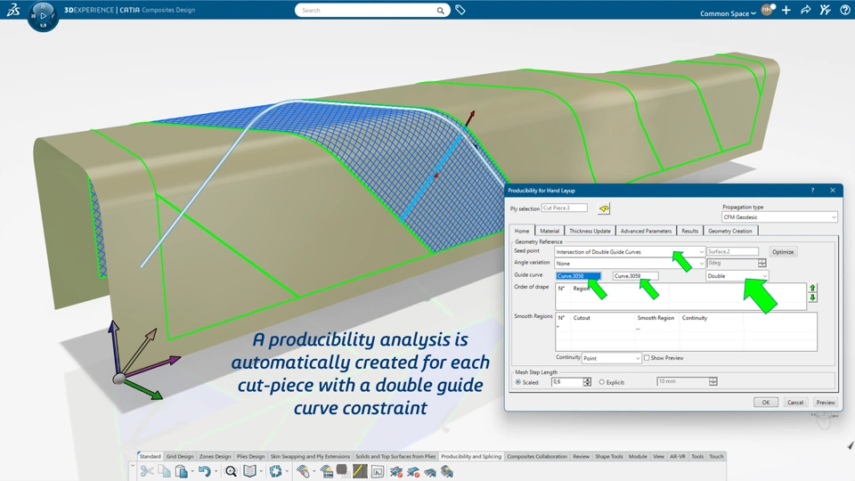

7. Ensure a proper fiber alignment of cut-pieces of plies with the automatic creation of producibility with double guide curve

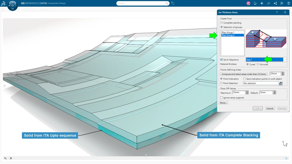

Enrich the grid design process with the ability to display information on the grid with the colorization of the cells
Calculate the generation of top surfaces for a given layer of the composite plies stack-up in order to streamline the creation of geometrical outputs required for relational design

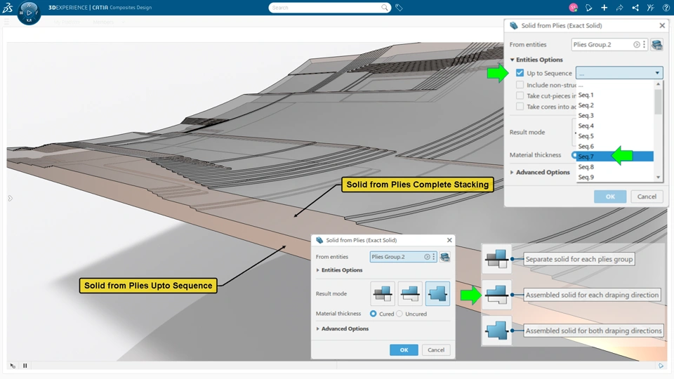

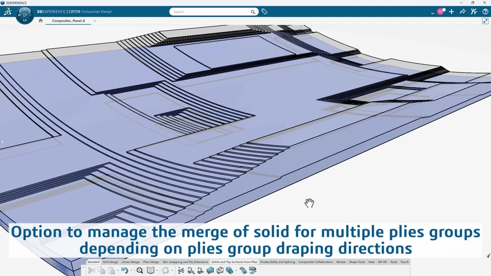

Generate solid from plies up to required sequence and manage options to merge depending on the plies group and the draping direction

On-the-fly creation of input wireframe geometry in the 3D Multi Splice command

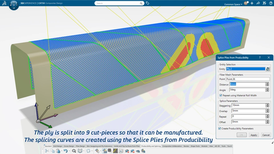

Automatic alignment of the splicing curves along the fiber direction
Automatic producibility analysis creation for each cut-piece with a double guide curve constraint
