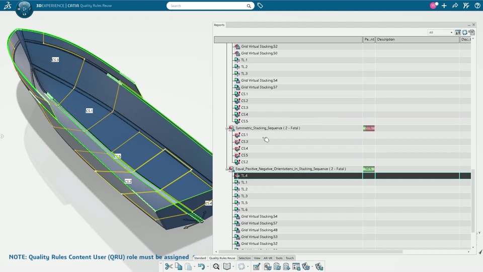

[CATIA] Composites Designer for Marine and Offshore

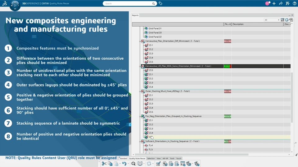

Improve the quality of composites part thanks to new composites engineering and manufacturing disciplines rules added to the Quality Rules Reuse application. The rules are :
- Composites features must be synchronized.
- Stacking sequence of a laminate should be symmetric.
- Number of positive and negative orientation plies should be identical.
- Positive & negative orientation of plies should be grouped together.
- Difference between the orientations of two consecutive plies should be minimized.
- Number of unidirectional plies with the same orientation stacking next to each other should be minimized.
- Stacking should have sufficient number of all 0°, ±45° and 90° plies.
- Outer surfaces layups should be dominated by ±45° plies.
What's New video R2026x FD02
