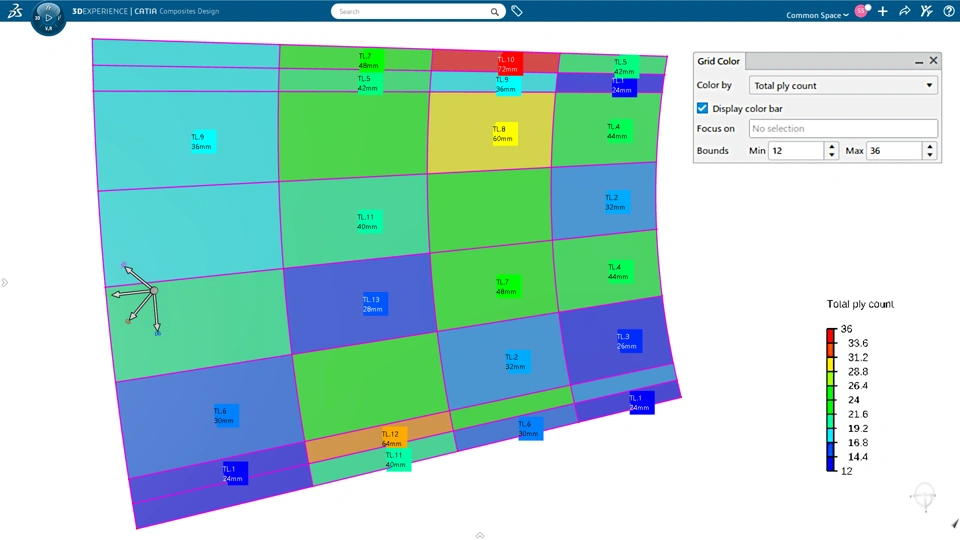

3. Enrich the grid design process with the ability to display information on the grid with a colorization of the cells

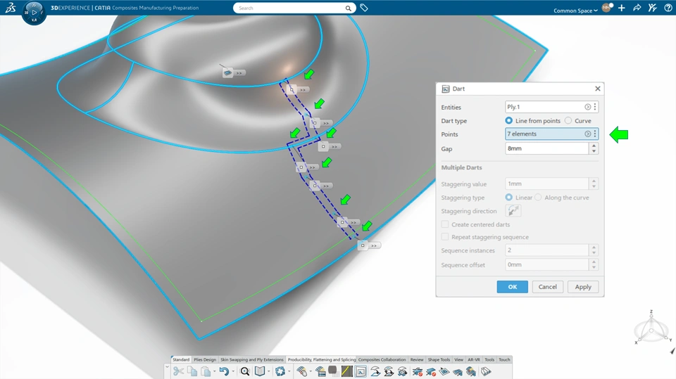

4. Manage complex manufacturing notches thanks to the dart command now allowing multiple points or an explicit curve as geometrical input

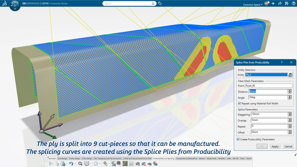

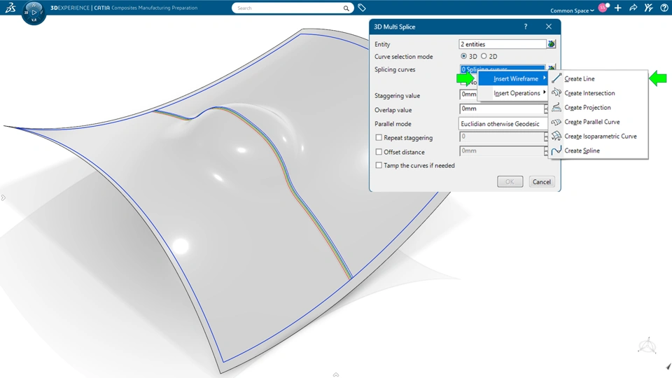

5. Streamline the creation of cut-pieces thanks to the ability to create splicing curves directly from the 3D Multi splice command

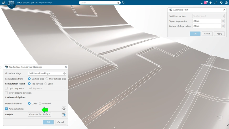

6. Automate the smoothing of the Top Surface from Virtual Stacking and Top Surface from Iso Thickness Area thanks to a dedicated auto fillet command

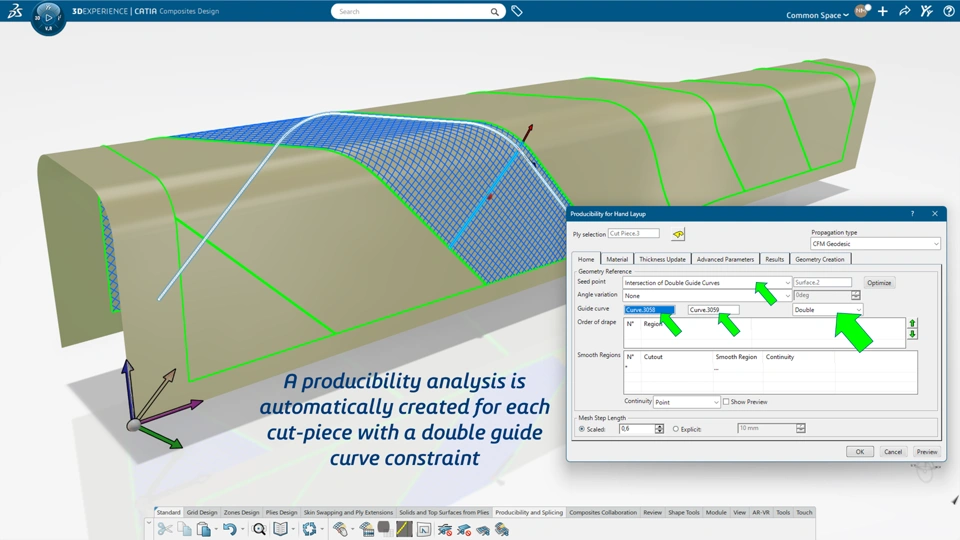

7. Ensure a proper fiber alignment of cut-pieces of plies with the automatic creation of producibility with double guide curve

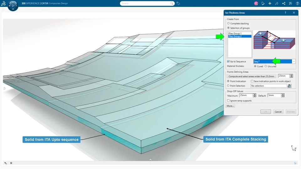

Enrich the grid design process with the ability to display information on the grid with the colorization of the cells
Calculate the generation of top surfaces for a given layer of the composite plies stack-up in order to streamline the creation of geometrical outputs required for relational design

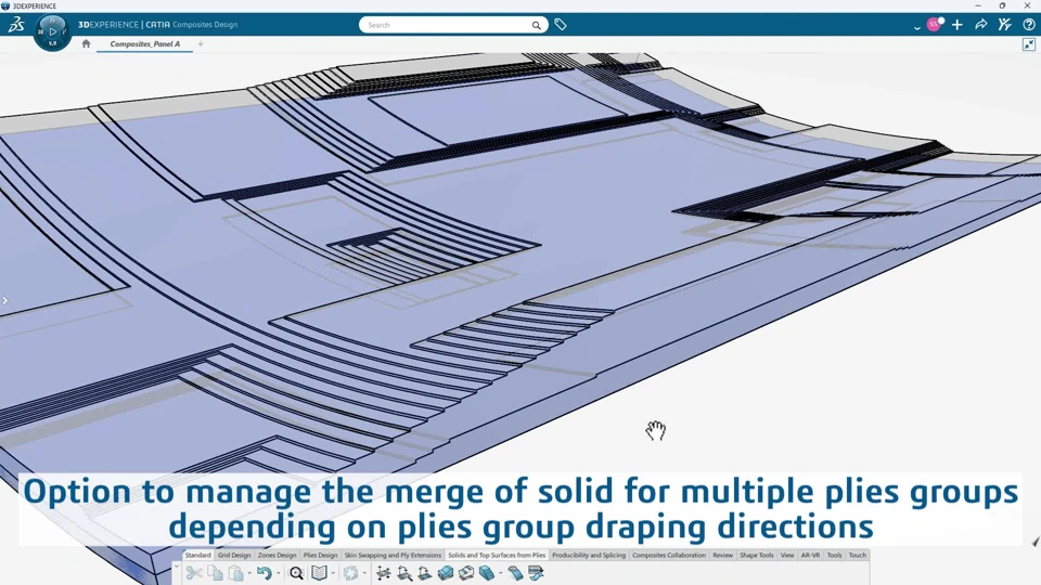

Generate solid from plies up to required sequence and manage options to merge depending on the plies group and the draping direction
Quick and easy creation of complex darts with on-the-fly geometry creation or polyline creation with indication points
On-the-fly creation of input wireframe geometry in the 3D Multi Splice command
Automatic alignment of the splicing curves along the fiber direction
Automatic producibility analysis creation for each cut-piece with a double guide curve constraint
