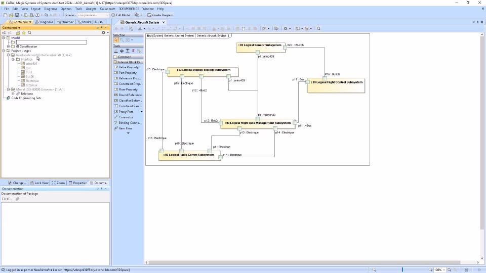

1. Model your mid to long term strategies and transformation scenarios with executable models of the universes from their purpose and mission to the key relations between its agents

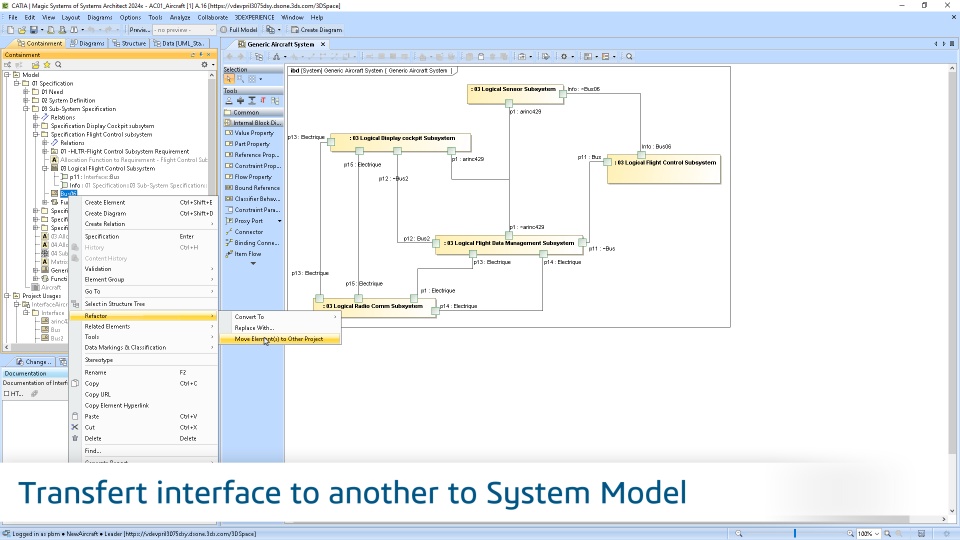

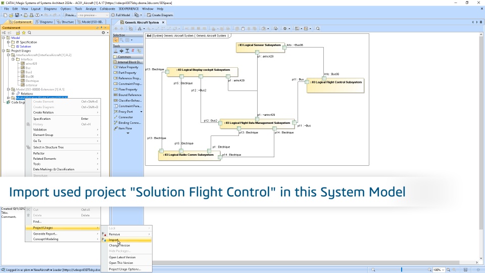

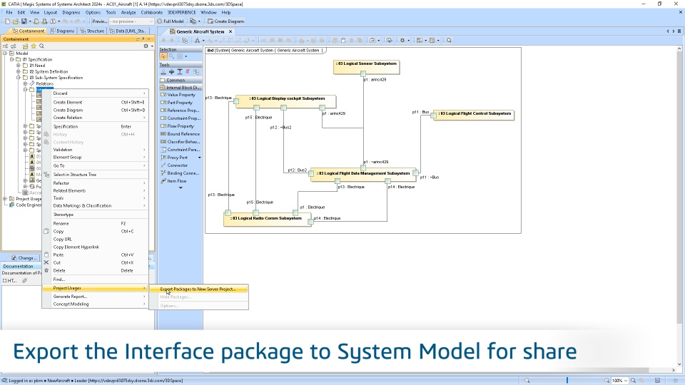

2. Reuse strategy leveraging use projects for both top down and bottom up workflows
- Move Element to another System Model (top-down design)
- Import Element from another System Model (bottom-up design)
