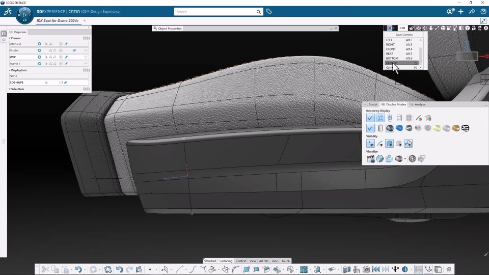

With 3DEXP-R2024x Golden release ICEM Design eXperience application focused all improvements on Usability, OmniSurf & Omnifillet tools, Selection efficiency, Display, Geometry quality and sculpting tools productivity
Many improvements in overall usability, selection efficiency, Omni-feature local tools & geometry quality, condition checks and geometry display, and sculpting tools productivity

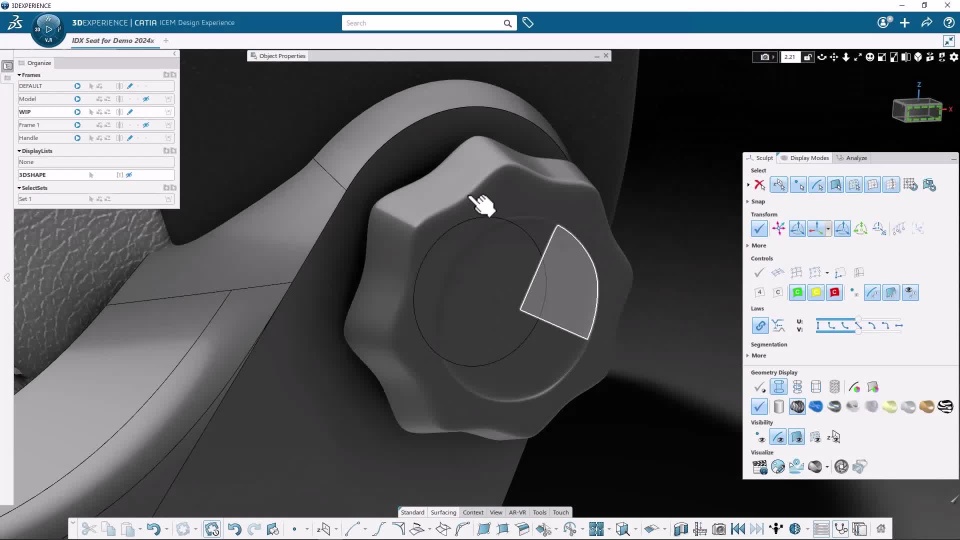

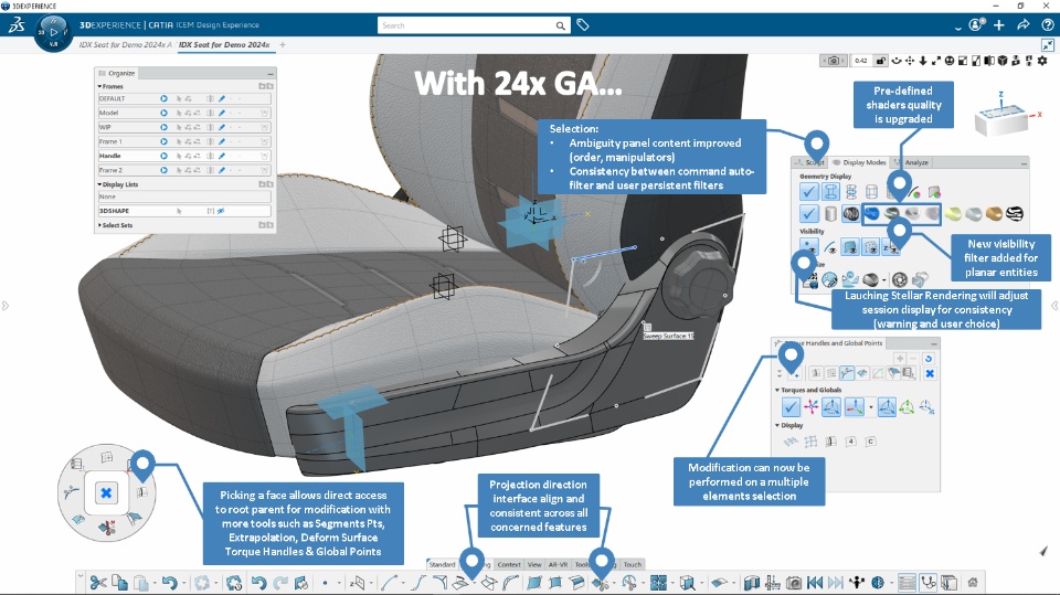

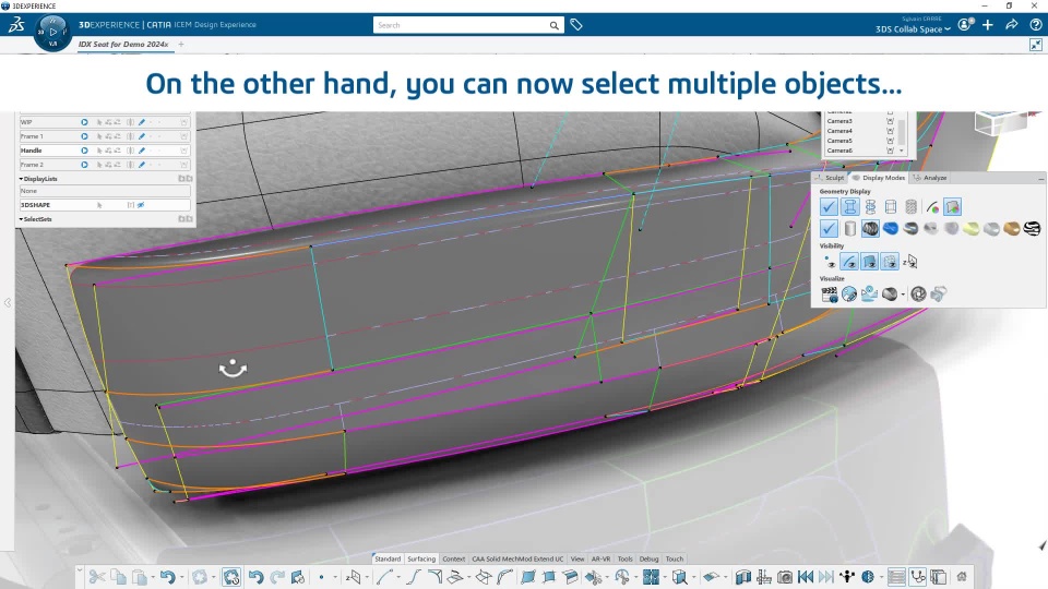

Modifying tools now allows multi-selection of elements, and are all able to prefer reaching root parent in case of faces selection

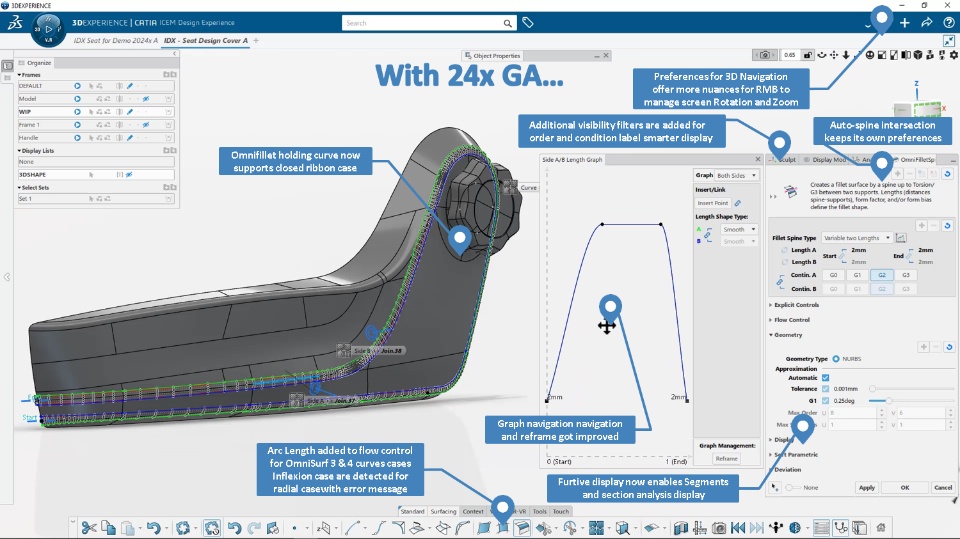

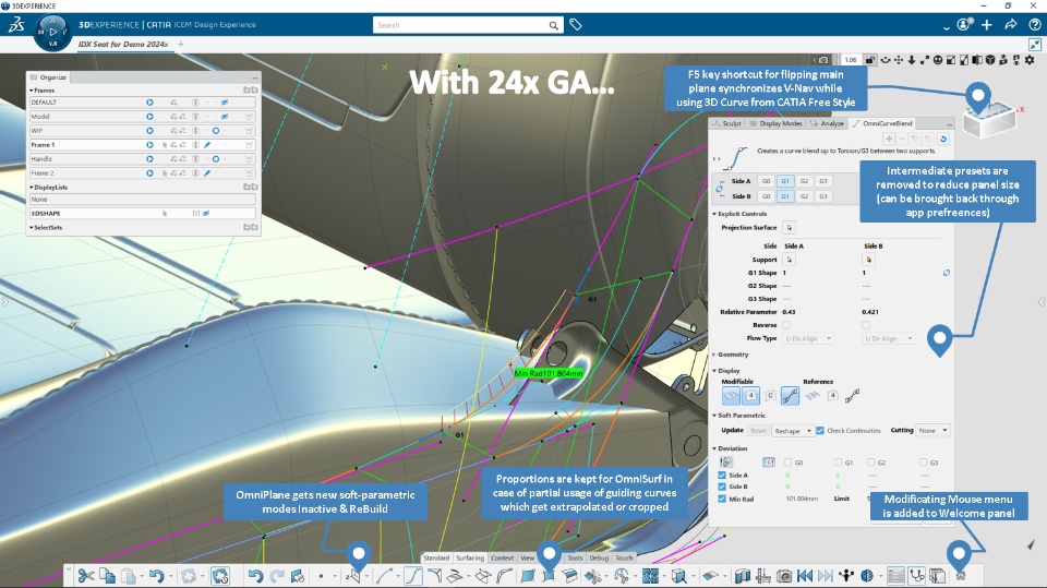

Geometry sequence robustness gets improved through OmniSurf & Omniplane associtivity scopes extention as well as surface quality get better options in OmniSurf flow control (Arc Length)
Omnifillet provides a better usability thanks to section analysis and easier Graph navigation in vase of OmniFillet with Spine. Robustness increases when holding a curve as it can be closed or not without any issue for fillet ribbon computation

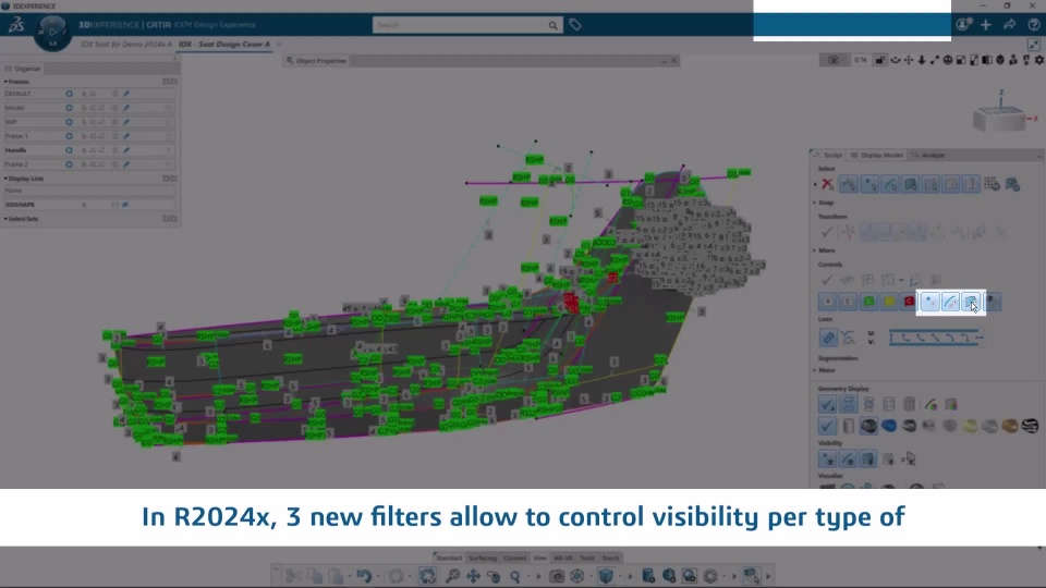

Additional display filters have been added to clarify geomery conditions and order labels visibility in case of complete model on screen

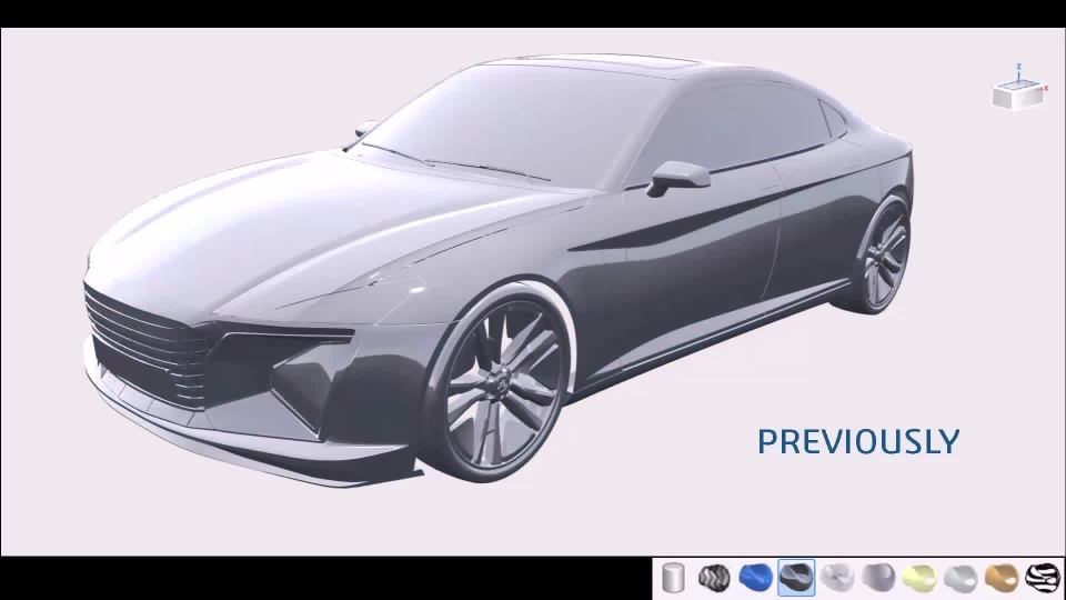

Quality of main pre-defined shaders was upgraded for a more comfortable visual diagnosis of the shape

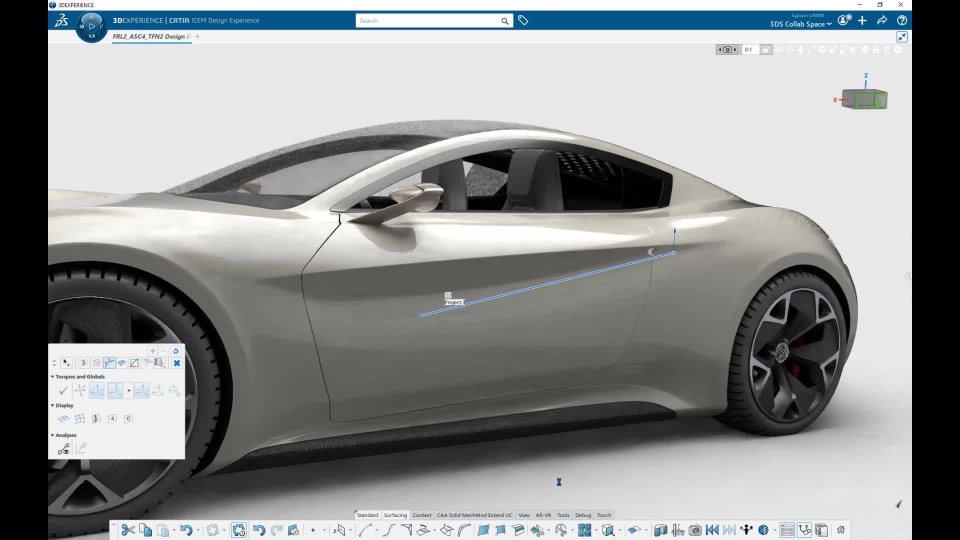

Using Stellar realistic rendering now forces display session consitency before computing, avoiding user to get unwanted partial results. User can then model with live raytracing.
