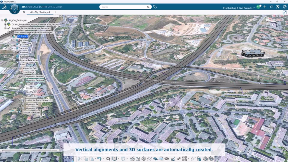

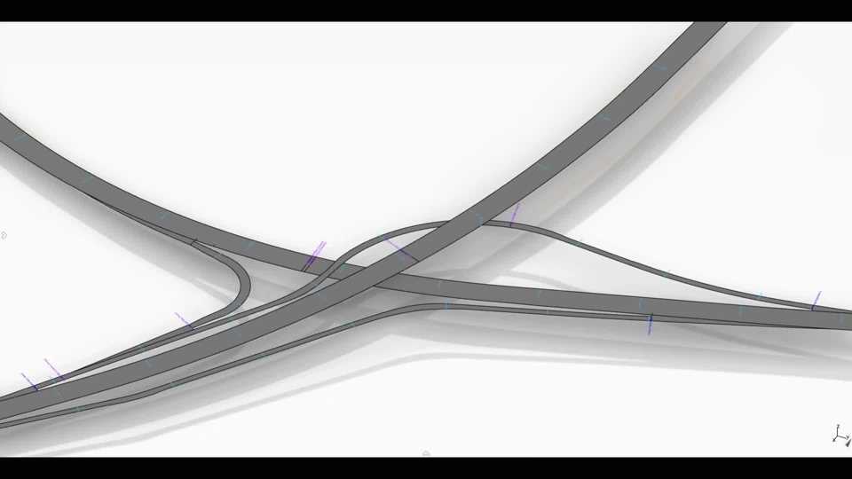

1.Design Complex Highway Interchanges by connecting fixed-profile road sections with precisely aligned ramps—supporting multiple ramp types and geometries for smoother transitions, streamlined layouts, and improved traffic flow.

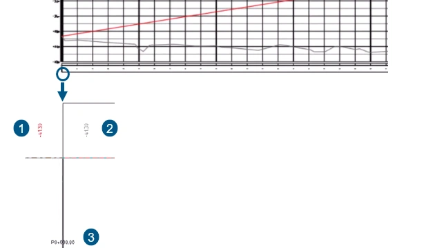

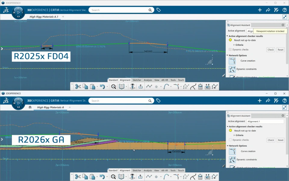

2.Enhance Vertical Alignment Representation with clearer views and band tables for more readable, streamlined 2D deliverables.

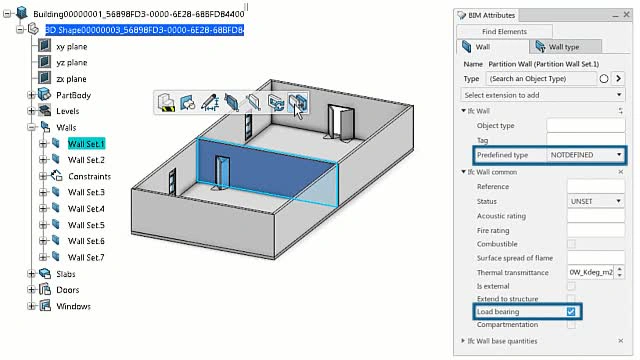

3.Easily define non-load-bearing walls to divide spaces—enabling more precise workflows and clearer distinction between architectural and structural views.

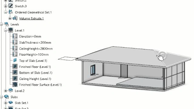

4.Generate surfaces for slab tops, slab bottoms, floors, or ceilings—ensuring accurate object placement that reflects real level geometry and elevation.

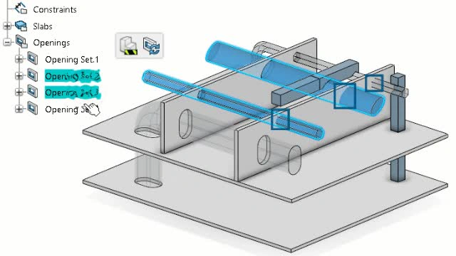

5.Access wall connections and openings with EKL—enabling automation and smarter detailed wall design by leveraging all impacting features.

1.Quickly update openings after design changes with one command—ensuring accurate cuts, improved efficiency, and time savings.

Designing Road Junctions and Ramps.
Displaying the Color Material In the Vertical Alignment Sketcher.
Creating Vertical Band Tables by Station. 1/ Elevation of the vertical alignment. 2/ Elevation of the terrain. 3/ Station values.
Creating Level Geometry as a Surface.
Creating Partition Walls.
Refreshing Existing Openings.
