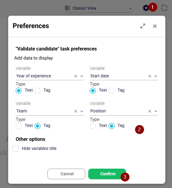

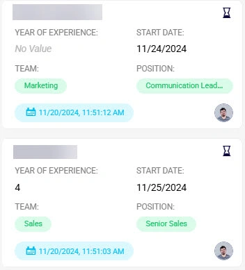

Displaying variables from task view
  • You can now display up to 4 pieces of information directly on the task tile or from the task table view:
Filter system by process

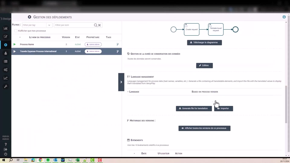

Multi-language management for new Play Interface
  • You have now the ability to translate process data (process names, task names, variable names and descriptions, etc.) from Design, for display to Play users.
    • For the moment, only the task view is available for translation.
