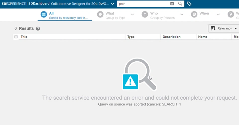

Search does not yield any results "search service could not complete your request"
Probable Cause:
  • This issue could occur due to the browser cache, or if the search service is down at that instance.
Probable Solution:
  • Clear browser cache or check in incognito window
  • Check 3DS website for service interruption, Click here
  • Submit a SR if above options does not solve the problem.

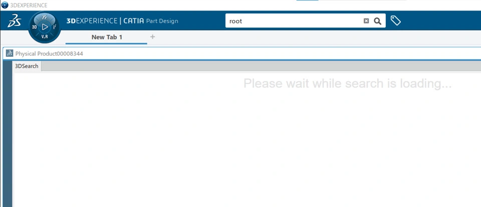

Desktop App Search keeps on loading and does not yield any results, "Please wait while search is loading"
Probable Cause:
  • This issue can occur after 3DEXPERIENCE Platform is upgraded, Ex: R2024x.GA to R2024x.FD01
  • The desktop cache from the older version can disrupt the desktop app search.
Probable Solution:
  • Clear desktop app cache after every upgrade as a best practice.
Desktop App Cache path :
C:\\Users\\<username>\\AppData\\Local\\DassaultSystemes
