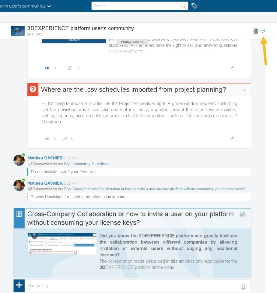

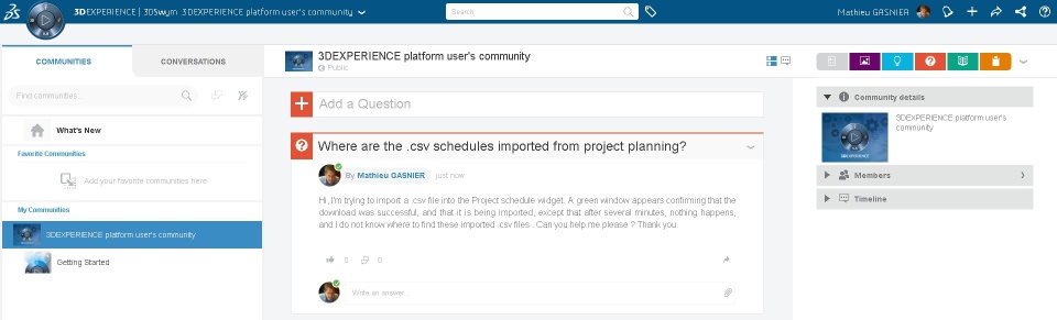

After many feedback received from our users, we are glad to announce that 3DSwym recovers its top to bottom feed in all its "What's new" feed, and communities "Contents" view. However, bottom to top display order still exists in the "Timeline" view and inside conversations.

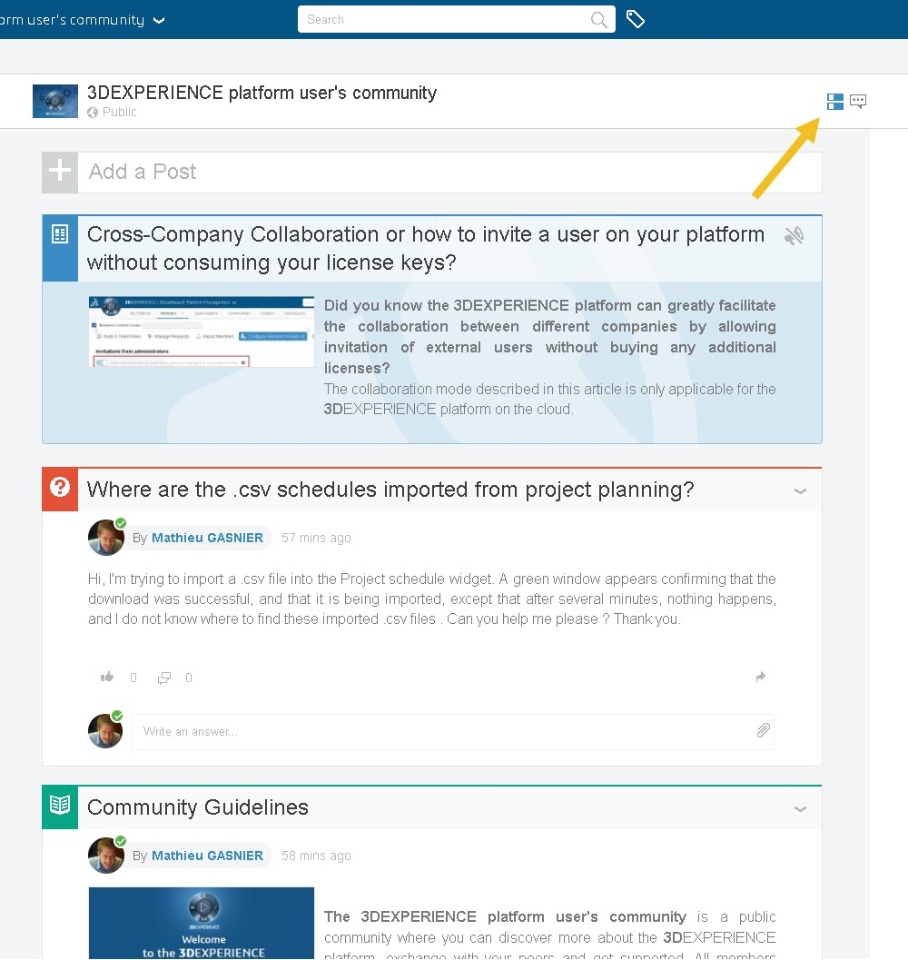

An explicit access to Contents or Timeline view
Change the display of a community feed thanks to 2 separated icons:
  •  to access the "Contents" view, where content is put first
  •  to access the "Timeline" view, where members activity is put first
                                                 "Contents" view                                              "Timeline" view

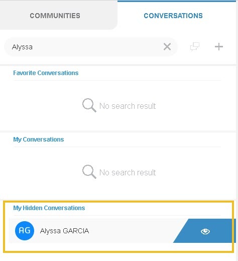

Recover hidden conversations
Get back to your hidden conversations by searching for the conversations' members.

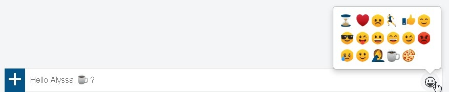

New emojis!
Some new emojis have been designed, for your greatest pleasure. 😃

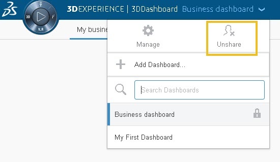

You can now leave a dashboard!
A much awaited feature: being able to leave a shared dashboard.
  • Reader or contributor of a dashboard
Member of a dashboard you don't want to be part of anymore?
Click on the dashboard menu and click on "Unshare" to leave the dashboard. It will just remove you from the dashboard and the dashboard will still be available for all the other members
Please note it is not possible to leave a default dashboard by role

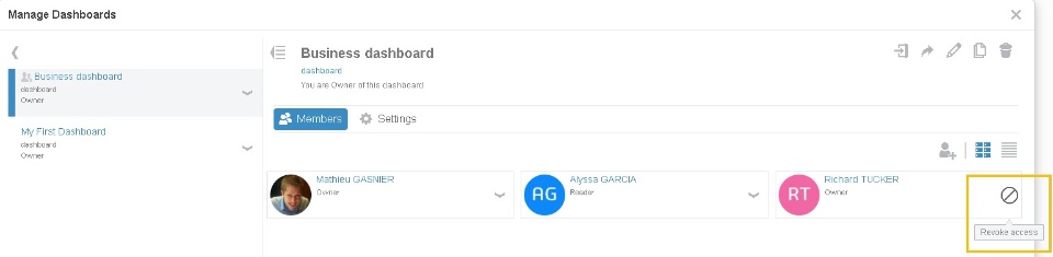

  • Owner of a dashboard
Even if you are set as an owner of a shared dashboard, you can still leave it. But you have a different way to do it. You need to go on the "Manage" space in the dashboard menu and click on the "Revoke access" button beside your name.
Once you have left a dashboard, you can't have it back unless an owner of the dashboard adds you one more time. Please be aware that the "Revoke access" button is only visible if there is at least another owner on the dashboard.

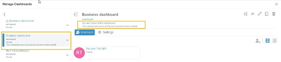

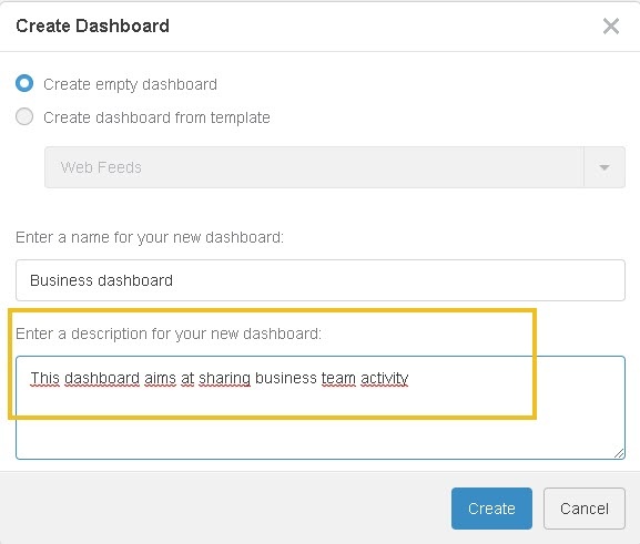

Add a description to your dashboard
Explain what is your dashboard about via its description. Thanks to that, all the people you have added to your dashboard can access to some information and precisions about the new dashboard they have been added to. ​​​​​​

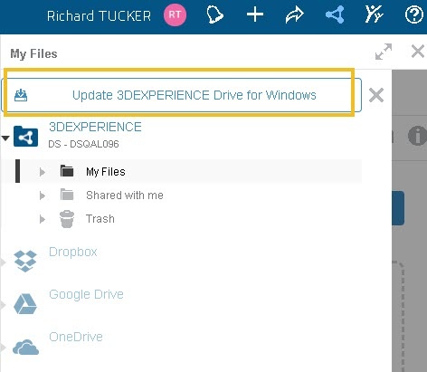

Easily update your 3DEXPERIENCE Drive for Windows via the web app
If you already have a version of the 3DEXPERIENCE Drive for Windows product on your computer, the "Install" button is changed for an "Update" button to let you download the latest version.

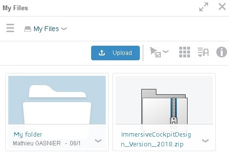

A dedicated button to upload files
It is now possible to upload documents in your 3DDrive simply by clicking on the "Upload" button, instead of having to select the "My Files" arrow.

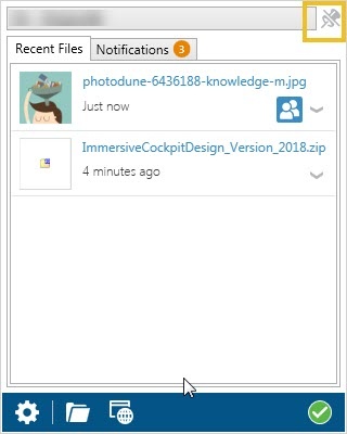

Lock the FlyOut panel
Be aware of all files added and their status by always displaying the panel from the task bar.

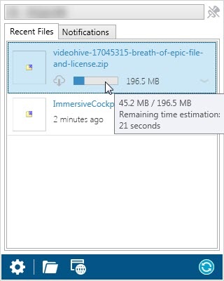

Remaining upload time
When a file is added to your drive content, you can visualise the time left for the transfer to be completed. Simply put your mouse on the progress bar.

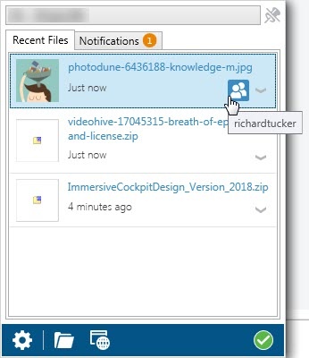

Find out who added the files
Via the FlyOut panel, discover the name of whom has uploaded a file in a shared drive.

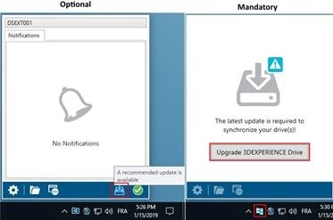

Update your 3DEXPERIENCE Drive for Windows!
Download the latest version of the 3DEXPERIENCE Drive for Windows to get the new features. With this new version, minor upgrades will be downloadable directly from the FlyOut, without having to open the 3DDrive Web version.

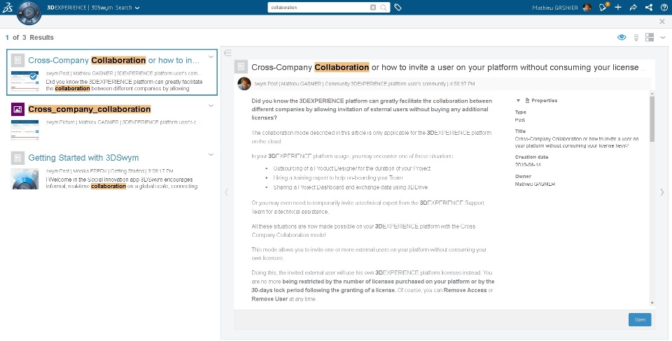

OneSearch, an improved new search
  • Search in all the 3DEXPERIENCE platform from wherever you are. Using the global "Search" brings you results from all services of the platfom: 3DDashboard (coming soon), 3DSwym, ENOVIA Applications.
  • Read an intuitive search results list. OneSearch offers a better readability of the results, thanks to the improved textual tiles (default view) where your search keywords are highlighted.
  • Get suggestions while typing your search keywords, based on the existing indexed content.
  • Preview the results of your search with one click, to ensure you found the correct content.​​​​​​​
