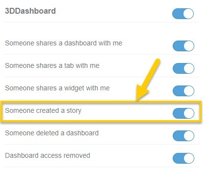

  • When you create a new story for your dashboard, members of the dashboard will receive a notification about the newly created story. This notification can be disabled from your 3DNotification's settings

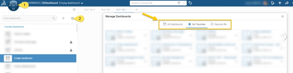

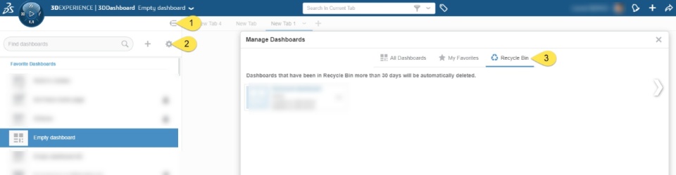

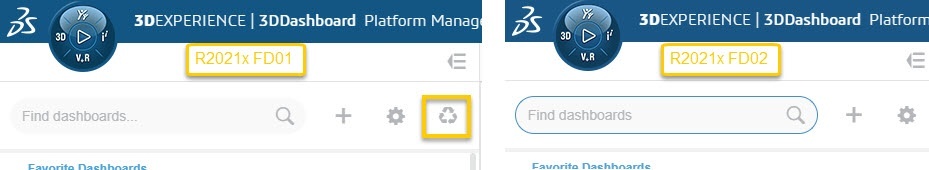

  • New Manage Dashboards menu: 3 Tabs present for All Dashboards, My Favorites and Recycle Bin
  • The Recycle Bin is no longer accessible from Dashboard List menu.
    As indicated previously the Recycle Bin is now located within the Manage Dashboards menu.

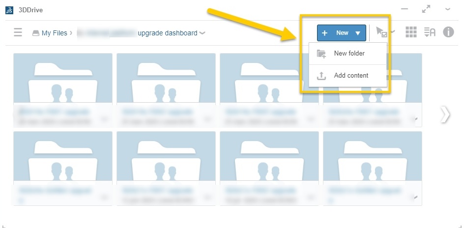

3DDrive

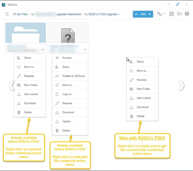

  • It is now easier to add new content in 3DDrive. You can use the "+ New" menu to add a New Folder or add new files
  • It is also possible to right-click on the empty area of the content view to get the contextual action menu for the currently open folder.

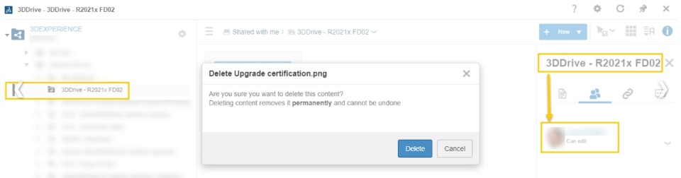

  • Creator of a file in a shared folder with just ‘Edit’ access can now delete its own files from the 3DDrive web app. When doing so, the file is permanently deleted and is not moved to the trash. Previously, only users with Can edit & share access were able to delete files in shared folders.

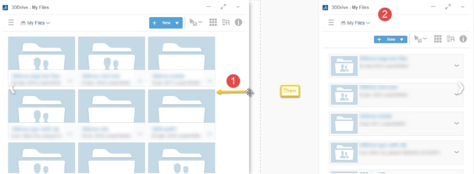

  • There is a new responsive behavior for the content view, when reducing the width of the app. When only 1 item can be displayed on a row, the view is switched to the one illustrated below.

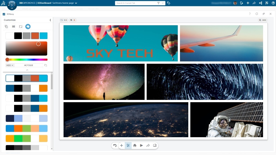

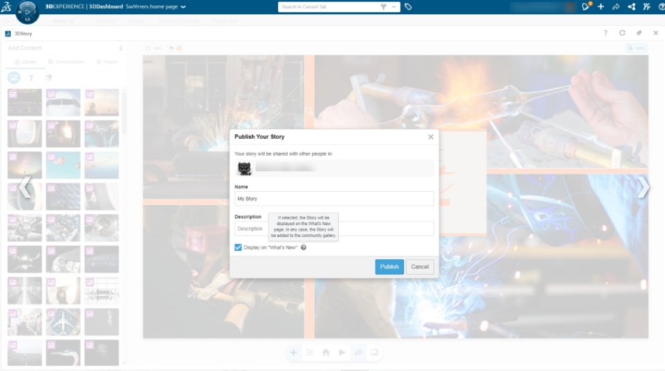

3DStory

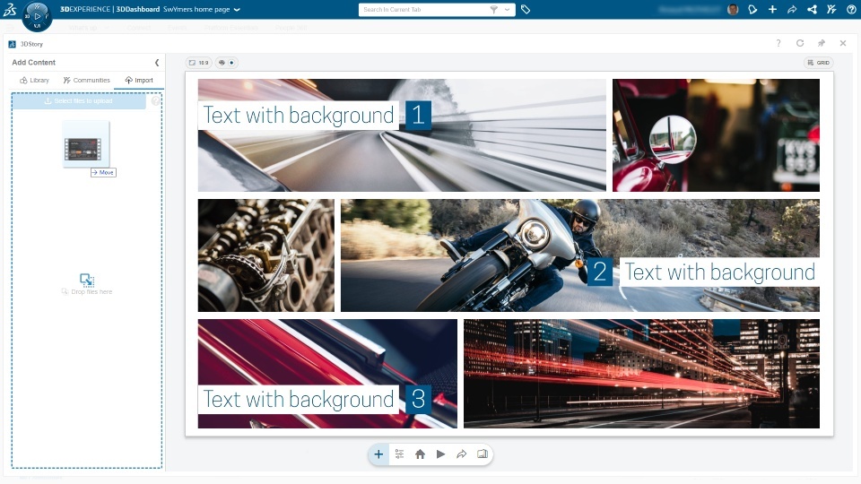

  • Local Media support: Direct drag & drop of local media files and clipboard content inside your story
  • Accurately choose a color thanks to improved Color Picker with RGB and HEX color display, including copy/paste capabilities

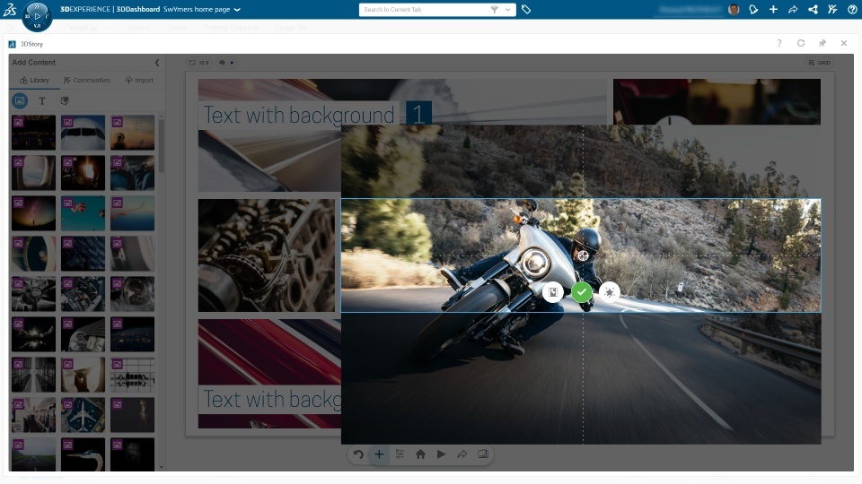

  • Image Focus Point Picker: Define a point of interest in your image, to keep it visible for every size and ratio configuration

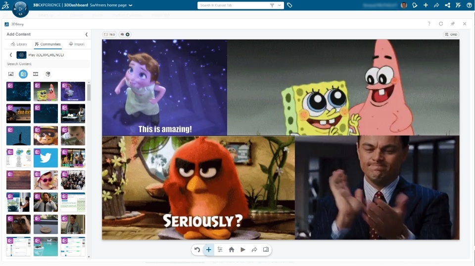

  • Animated GIFs are now supported

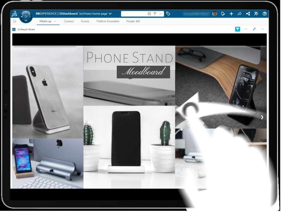

  • Improved touch support: you can now swipe between scenes inside 3DPlay
  • More control on publish with "Display in what's new feed" option from publish panel

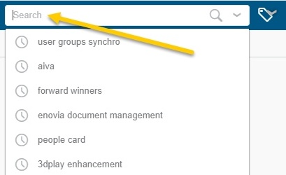

3DSearch and 6WTagger

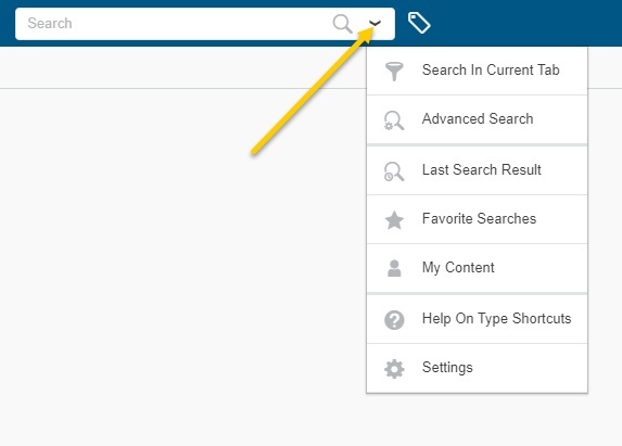

  • The 3DSearch TopBar has been simplified. When you click within the search bar, you will see your last 10 searches, it no longer displays the different search options.
    If you want to display the different search options, you will need to click on the chevron to get to the search options. Notice the "My Content" direct search in this menu, to list all your content in the platform, that can be filtered using 6WTags.

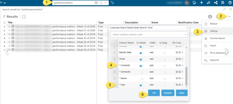

  • Search Results in datagrid view now provide the capability to display all attributes defined in Tagger. As an example, for 3DSwym posts, you are now able to add Comments and Likes information in additional columns of the datagrid view.
