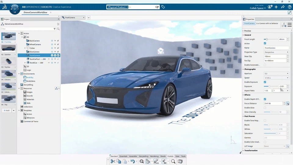

New Camera Workflow
- The workspace of the Creative Experience editor has been restructured, providing new ways to set up cameras for batch rendering through the redesigned canvas.
- The canvas header now allows for direct switching between different cameras and instantly update the camera from current viewport.
- The camera aspect ratio can be visualized in the canvas.
- Panels no longer overlay the canvas, ensuring the complete visibility of the rendering camera.
- One click creation of new cameras based on the viewport of backplate ambiences.
