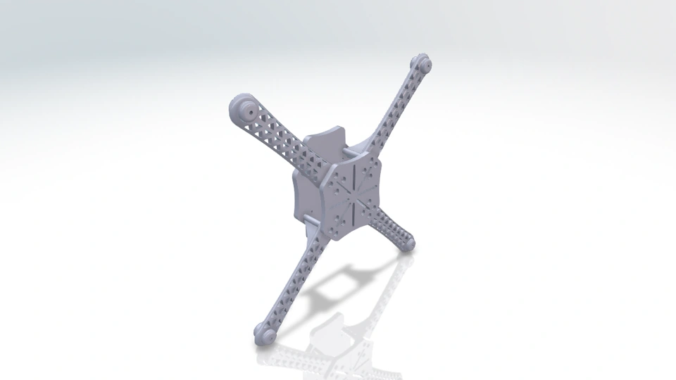

Drone Body Step File :
The provided drone has the following specifications:
ParameterSpecification
Drone Body Material ABS
Drone Body Mass 500 g, without landing gear
Drone Bounding Box 430 mm × 430 mm × 79.5 mm, without landing gear

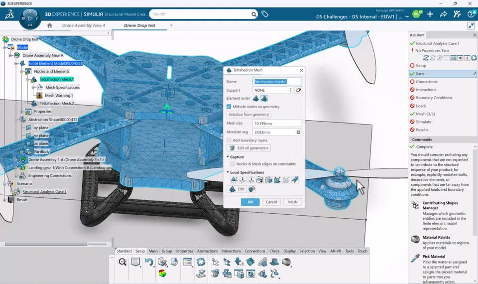

Step 3: Simulate
Set up and perform the required Dynamic impact simulation. You will be receiving license of 3DEXPERIENCE platform where you will have SIMULIA apps for simulation.

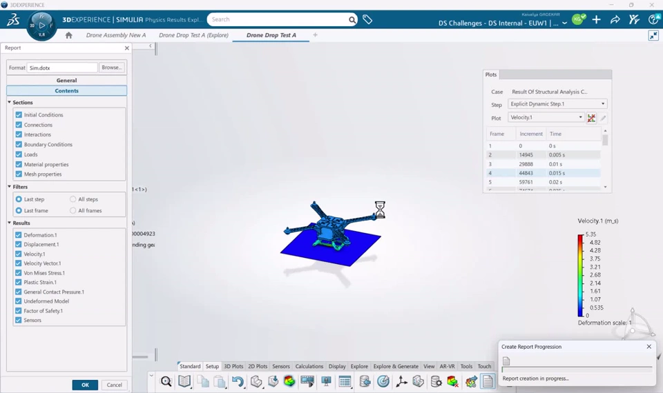

  1. Simulation Report (Can be exported through the simulation app. Please check below mentioned video for instructions to export)
