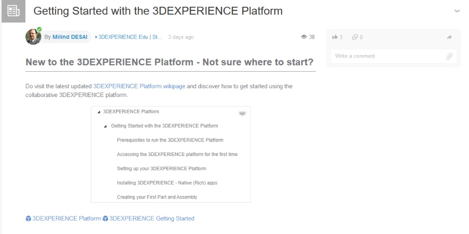

For example : Two What tags are added to the following post by specifying the following keywords at the end of the post:
#3DEXPERIENCE + What Tag, #3DEXPERIENCE Getting Started + What tag.
