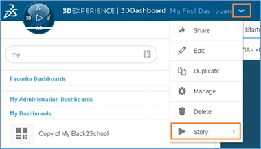

  1. Open your dashboard and click on Dropdown.
