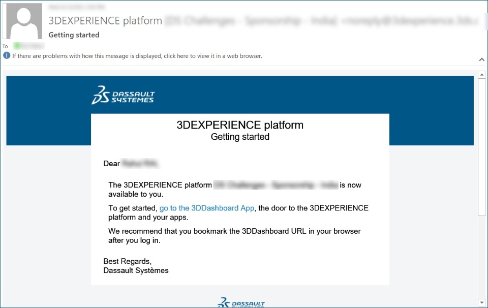

2. Open the invitation email and click on the link to 3DDashboard App
Once the Administrator grants a role, you will receive an invitation email, you need to accept the it through the link.
Save the link (Bookmark it) or Access your Platform from https://go.3ds.com/educloud . Access using a Web browser.

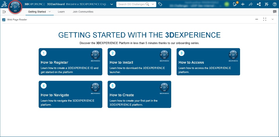

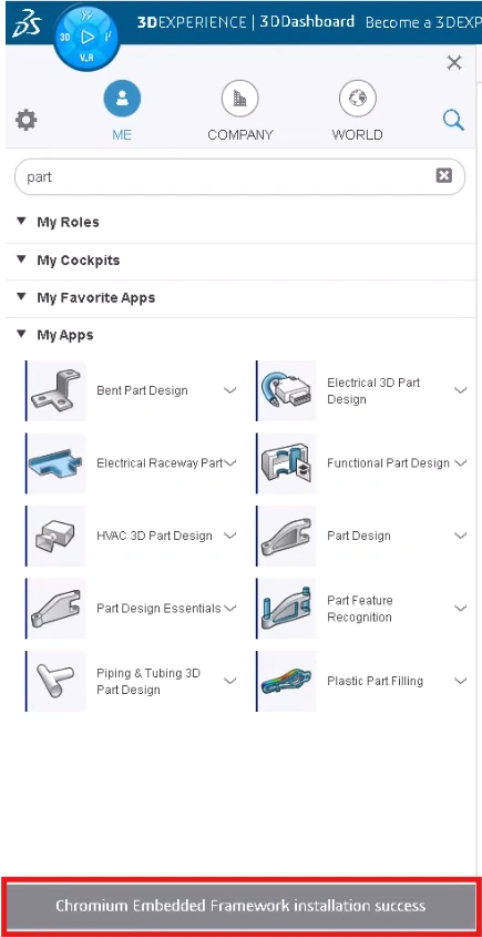

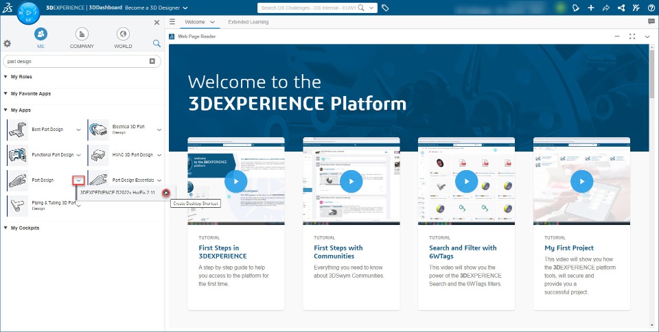

3. Click on the 3D Compass
Log in to the 3DEXPERIENCE platform and Click My Compass (Top-left corner of browser).

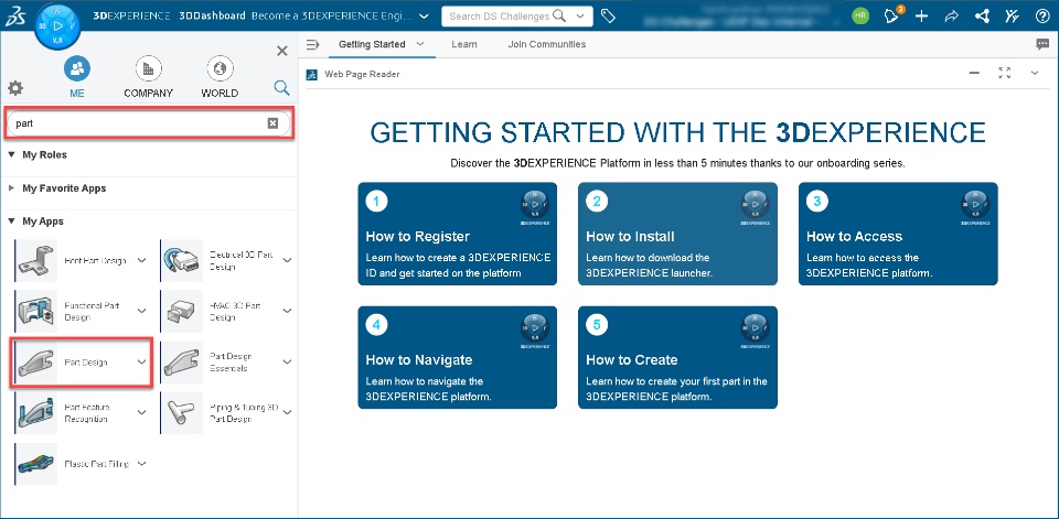

4. Search and Click Part Design app. Installation automatically begins.
NOTE: If you are not able to see apps like the ones in the screen below and you're seeing a bunch of advertisements on clicking the 3DCompass, then you are not using the right login link. Please use correct Login Link and set it as a Bookmark.

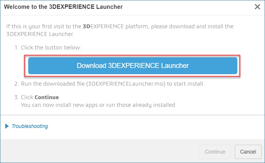

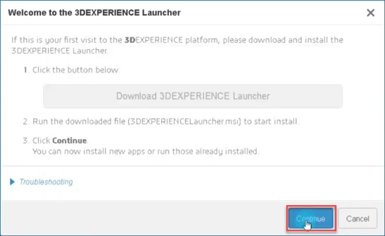

Opening any design app will install CATIA 3DEXPERIENCE on your machine. If 3DEXPERIENCE Launcher is not already installed, you will be prompted to install it first.

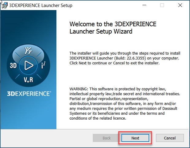

                   a) Click on Download 3DEXPERIENCE Launcher
                  b) Run the downloaded file.
                  c) Follow the setup instructions.
                    d) Click on continue.

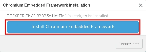

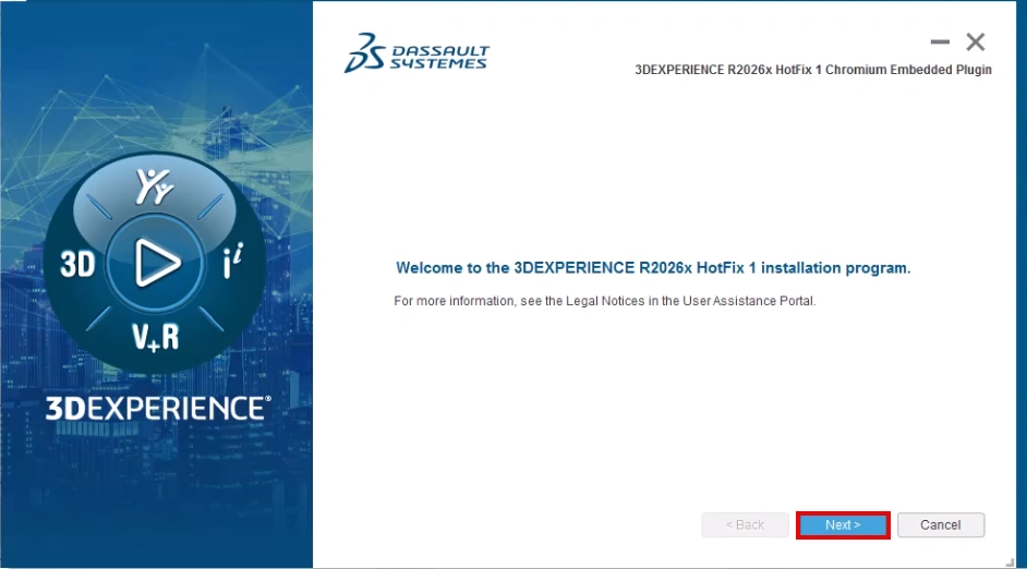

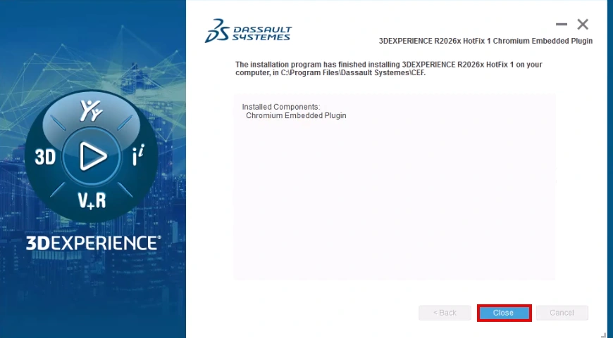

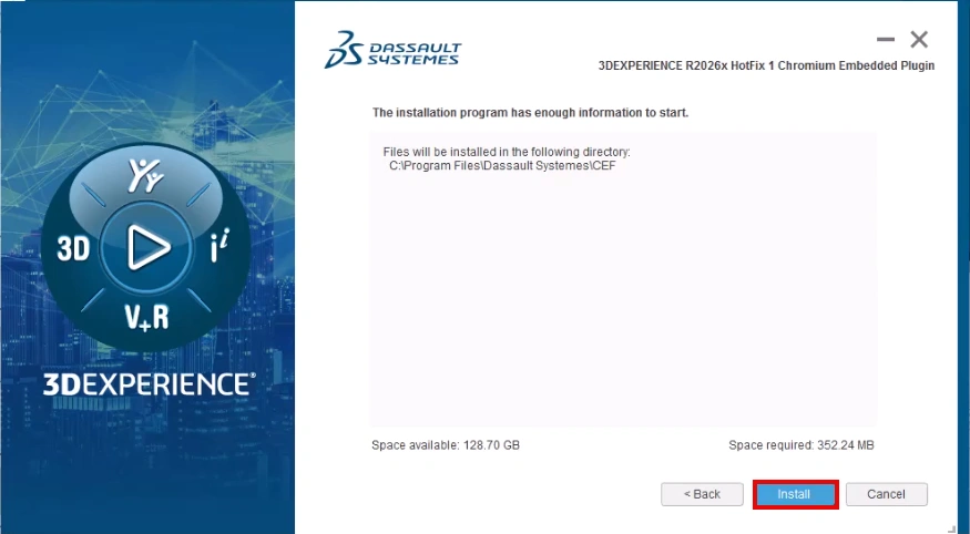

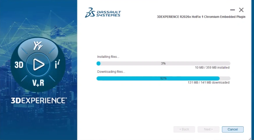

Note : After Installing the 3DEXPERIENCE Launcher you will be prompted to install the Chromium Embedded Framework (CEF) if not already installed. Please follow the steps below.
a) Click on "Install Chromium Embedded Framework"
b) Follow The Setup
c) Download and Install the CEF.
Note: After the installation if the process doesn't start automatically then Click on Part design app again

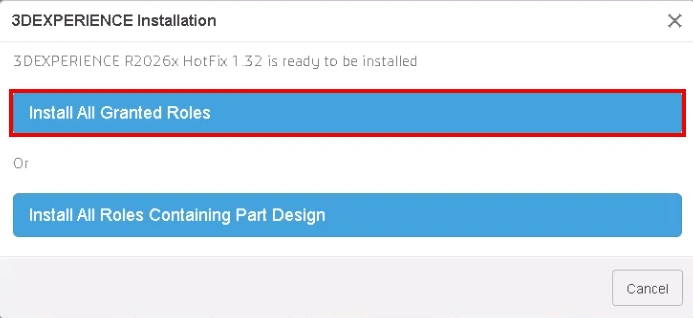

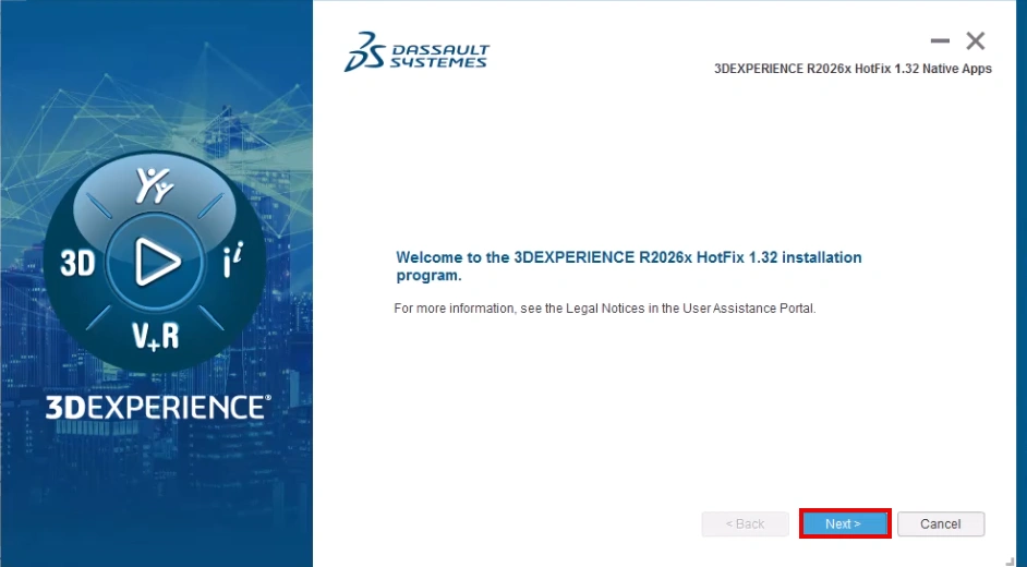

5. Click on Install All Granted Roles.
3DEXPERIENCE CATIA installation file set will be downloaded via the 3DEXPERIENCE Launcher, and the installation should proceed automatically.

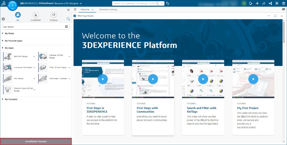

6. Follow the setup instructions
7. Message: Installation Success
8. Create Desktop Shortcut
You can create a shortut of a native app on your desktop.
