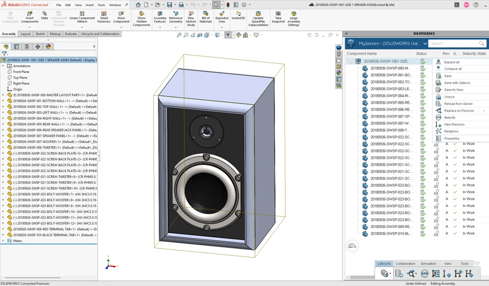

- Use 3DEXPERIENCE SOLIDWORKS Premium on the tenant to save files to the platform. Once data is on the platform (Collaborative Space, specifically), it can be used across other Apps.
- Or install Collaborative Designer for SOLIDWORKS, a small addin to your desktop SOLIDWORKS, to save files to the platform.
- Or import SOLIDWORK parts, STP files or other formats to xDesign on the platform. Then these models will be usable in xStudio😄
