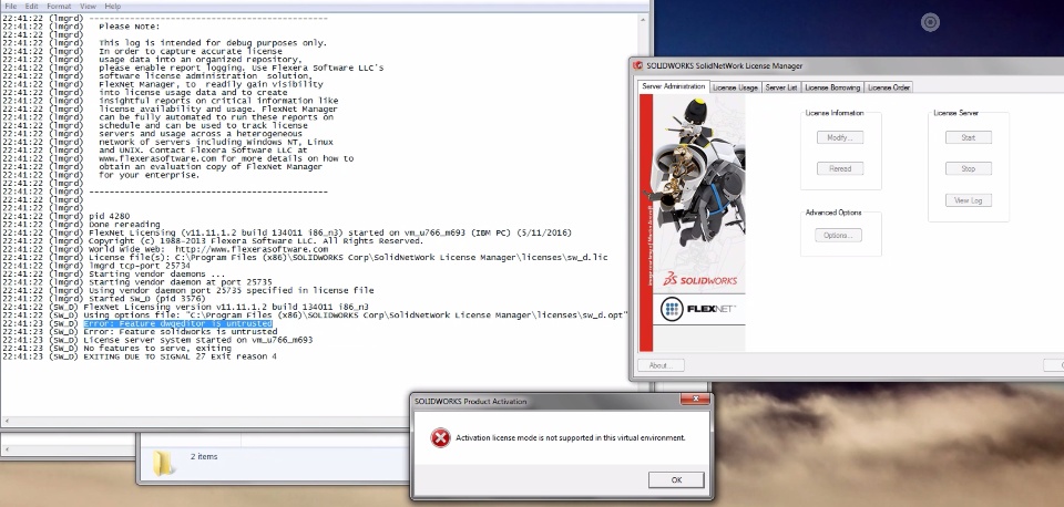

We run SNL Server on a Virtual machine along with SW 2015 SP0 and have for the last 4 months with no issues.
Today when we went to login we received an error "Solidworks: activation license mode is not supported in this virtual environment". The license no longer shows in SNL and I am unable to add it without getting that error.
Screenshot of error and log file for starting SNL attached.
Any ideas?
