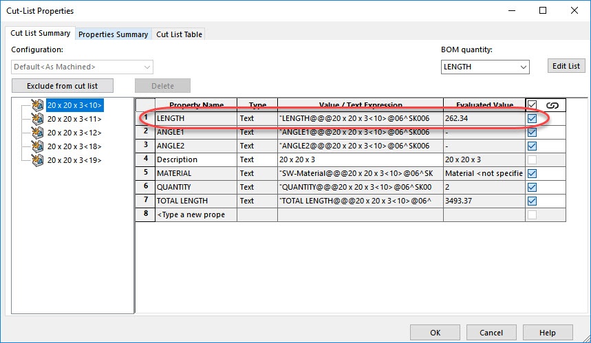

Wrong weldments part length in Cut list
After years of using sheet metal, my first try in weldments.
What's this extension and how can I prevent it.
Because of this, cut list's length shows as 262.34 while it should be 234.0
Assembly and used structural Member is attached.
Any kind of advice is appreciated.
