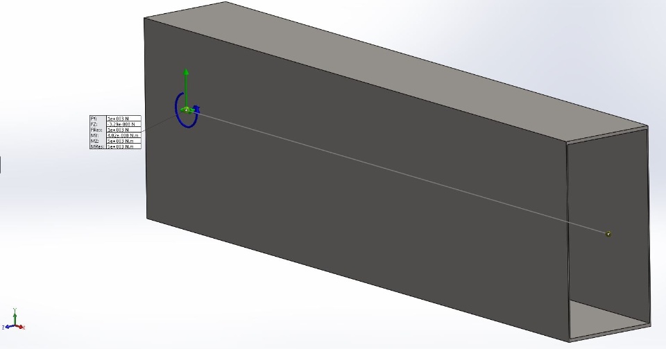

I'm starting to use Solidworks Simulation (2014 SP3). I'm trying to do a simple example before designing and calculating a bigger structure. The example consists on a box section beam fixed (displacements and rotations) on one side, and a local force applied on the free side.

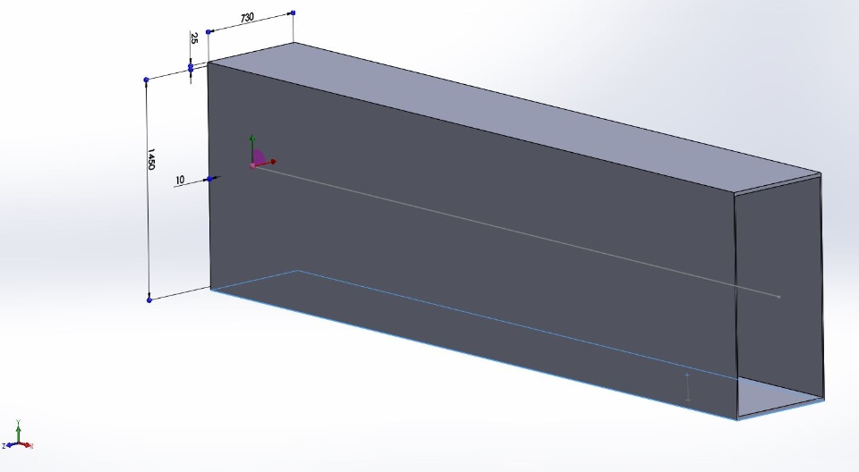

Please check image1.jpg. The box section is height 1450 mm, width 730 mm. I think that thicknesses are irrelevant.

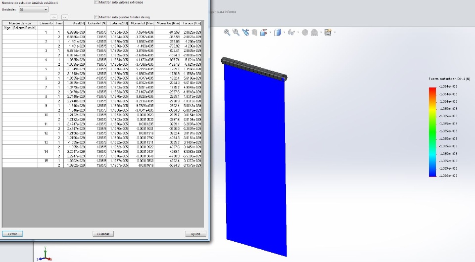

The length of the beam is 5 m. The force applied is 1000 N. Obviously, the reaction force on Y-axis is 1000 N and the moment reaction on Z-axis is 5000 N·m (check image2.jpg), but the shear diagram (and also moment) doesn't match with the theoretical results. It should also be 1000 N constant along the beam (please, check image3.jpg).
I thought it could be because of the relation between the height and the length of the beam, but I have increased the length to 30 m and the results are the same.
Am I missing something or doing something wrong? May anybody help me clarifying this issue?

indeed I also think it should be a different value.
Can you upload the model so I can have a look in a different version?

in 2015 SP4 I do get the correct result. I did not change anything and just pressed run.

I have replicated the issue with my version of 2014 SP4, I can see a similar SR on the knowledge base that suggests it is fixed in SP5.
I will try and update to SP5 and test
