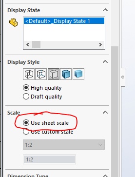

When creating a drawing to export as a DXF, I always place my first view, ensure that the "Use sheet scale" box is checked, then go about placing different views, dimensioning, etc..
