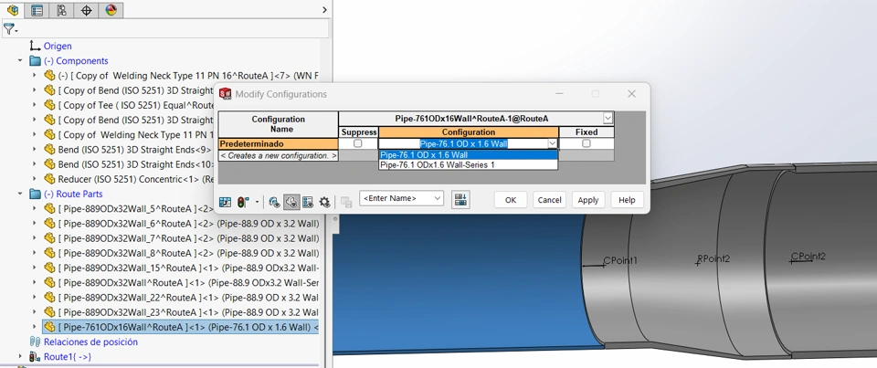

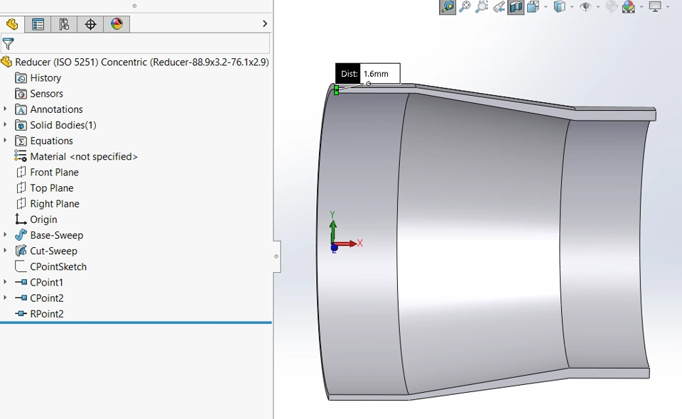

While working with the routing add-in, I see that the "Reducer (ISO 5251) Concentric" from the SOLIDWORKS library has incorrect values for one of its ports.
More specifically, im working with a 88.9x3.2 to 76.1x2.9 reducer. The 3D model, however, shows a thickness of 1.6mm for the diameter of 88.9, instead of the desired 3.2mm:
Not only that, but the pipe that connects to the 76.1mm port has a thickness of 1.6mm instead of the desired 2.9mm:
Is there a way to solve this, at least manually?
