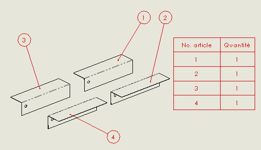

I've got an issue with a cut list. Please see this .gif:
these are the steps :

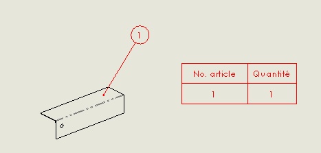

      1 - make a sheet metal with an hole (cut list is ok)

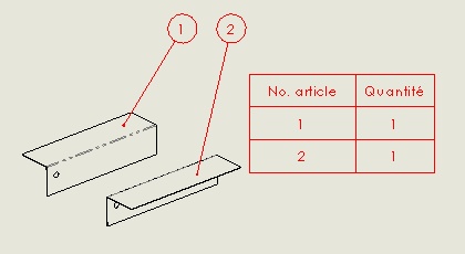

      2 - make a symmetry (cut list still ok)

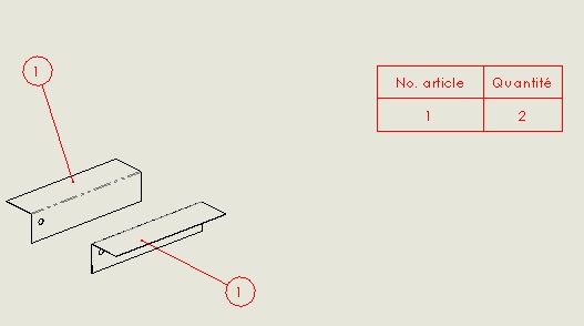

      3 - use the copy tool to make tow other bodies, and change the materal of the new bodies in the cut list (cut list still ok)
      4 - suppress the two first bodies, and the cut list is not good anymore (it will put item 3 and 4 in the same group despite not having the same geometry)
Weird thing is that is the delete body feature that break the cut list.
We have found a workaround, if you change the material of a body, the cut list update well. But that's not very handy.
Any idea on how to fix that?
